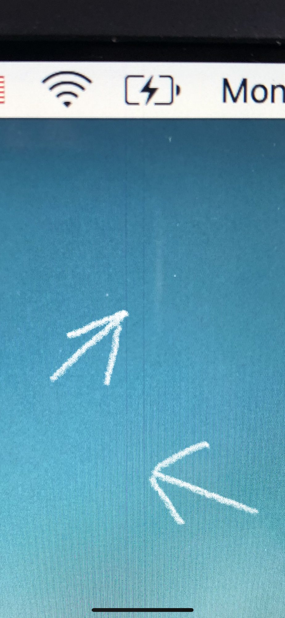

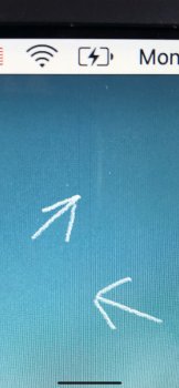

Hi All - I'm wondering if anyone here knows enough about monitors to help me diagnose this problem. I am experiencing very thin vertical lines (running top to bottom) of what appear to be dead pixels on my LG UltraFine 4K display. It started with one and another one just popped up today - I've attached a picture of what it looks like. Is it possible that this issue is the fault of the thunderbolt cable or is it most likely the internals of the display itself? If I were to open up the display I'm not sure which component would need to be replaced or tightened so I was hoping that someone has experienced a similar problem. I thought maybe I could rule out the thunderbolt cable being the issue if I could somehow turn on the display on its own without connecting my MacBook but there doesn't appear to be any way to do that.
Any help would be much appreciated!
Thanks

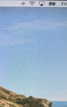

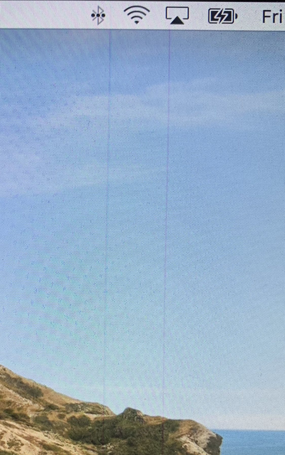

Hi there, did you fix this issue? I have the same trouble.... any help / advice appreciated - thanks!
