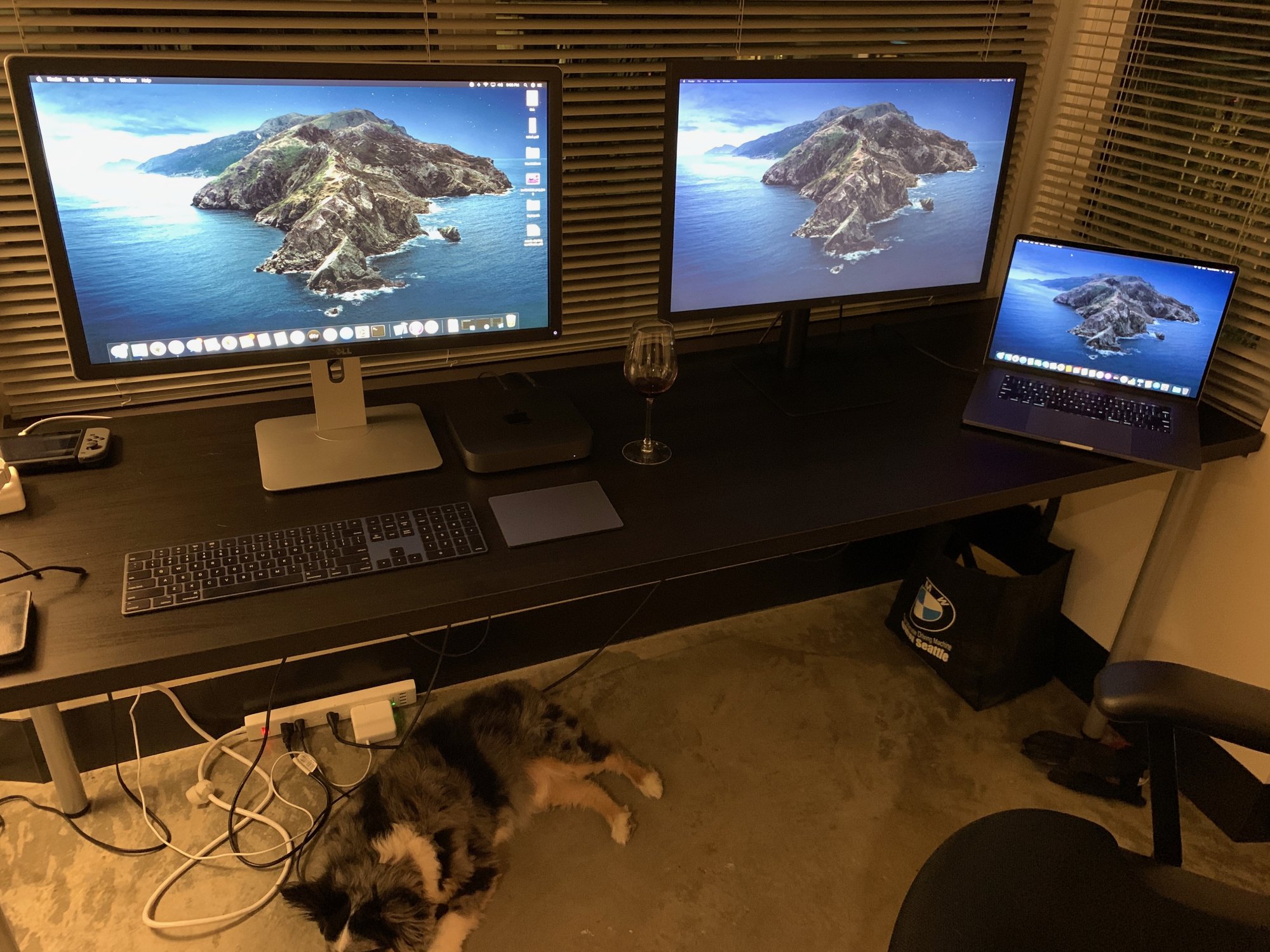

Yesterday I sprung for a 16" MacBook when I found out my local store had a 32GB model in stock, and I decided to go ahead and upgrade my monitor to the UltraFine 5K at the same time.
I've been using a Dell P2715Q 4K monitor for years now, but I have an early version that freezes often (requiring power cycle), doesn't support HDMI 2.0, and I was never quite happy with the off axis color (until now). The UltraFine 5K seemed like the reference monitor to get, with a price to match. Despite the weird bezels, most reviews rave about the panel quality.
After a couple of days with the UltraFine, however, I'm a bit disappointed I'm not sure what to do with this display yet.
1) Issue #1 - off axis viewing
Out of the box, I felt like the UltraFine was washed out compared to my Dell 4K. As I moved around, I noticed this was because the off-axis viewing seemed to suffer a lot. As a matter of fact, it seems so bad that I get off-axis discoloration in the lower corners of the monitor looking at it STRAIGHT ON.
Most reviewers say this display has pretty good off-axis viewing, but this seems blatantly unacceptable to the point that I'm wondering if there is something wrong with my monitor. If I raise the monitor all the way, and tilt the bottom out to the max distance, I can get the wash-out to go away, but that's an insane angle to use the monitor at.

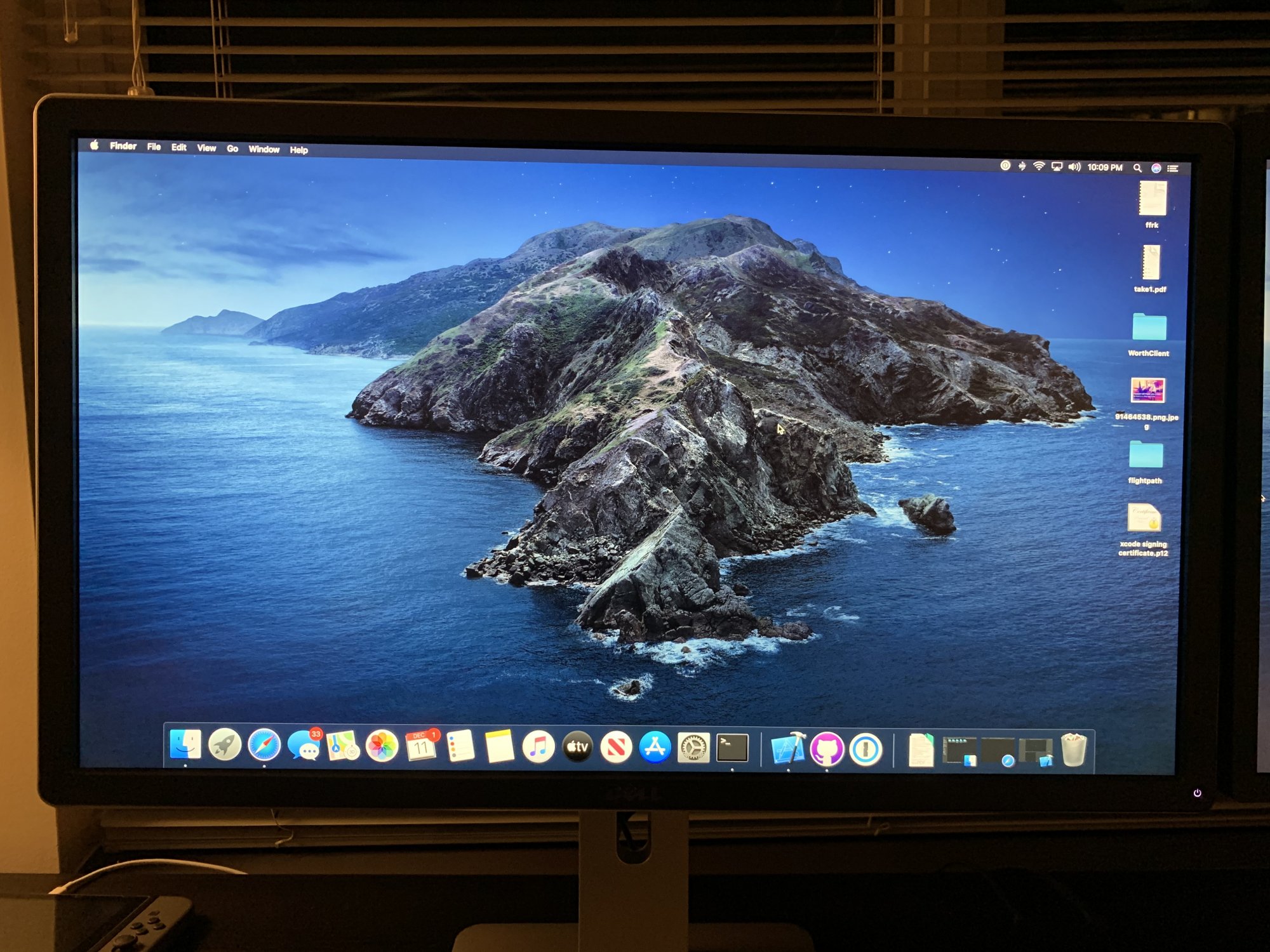

For reference, here is the Dell from the same angle:
2) Issue #2 - Color
The color of this monitor just seems inferior to the many-years-old Dell. Looking at the MacOS wallpaper both the Dell and MacBook have a deep blue hue, but the LG has kind of a washed-out more purple-is look to it.
I have tried all the different color profiles, settings etc. It's a little hard to tweak the LG display since it has no external controls. But I'm wondering... did I get a dud UltraFine? Does this display just suck? Is there something wrong with my eyes? Everyone says this is the "same" at the iMac display, but I've never seen these things in an iMac. I'm having a hard time believing this display is worth 3x the price with the quality I'm perceiving here.
I was wondering if this was a glossy vs matte issue, but this room is pretty dark in the evenings so external glare isn't much of an issue.

Thanks! Honestly, it looks incredible on those tests on the bright screens.
The issue I'm having is that I perceive a ton of off-axis washing out on darker screens. I'm having a hard time believing that it's a defective panel - it seems to WORK fine, I'm just really sensitive off-axis backlight bleed. I always noticed it on my Dell too, but I think it's amplified with the glossy coating on the LG display.
