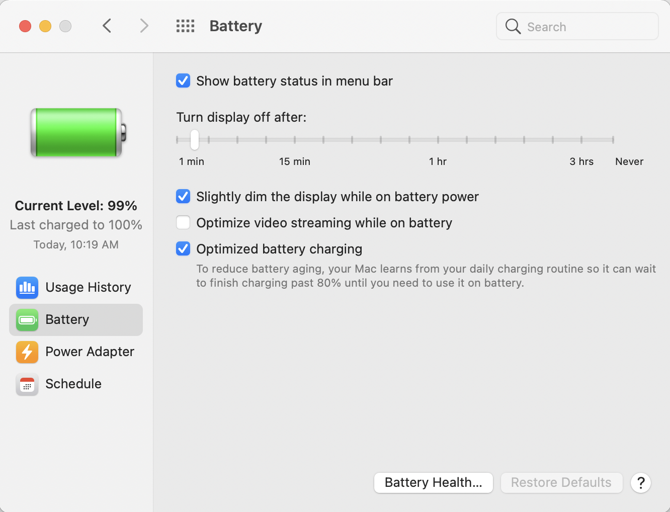

To look at nits in the console log run the Console app. Click on "Start streaming" then type nits in the search box and hit return. Hit the brightness keys and you will see the data. I set my System Preferences - Energy Saver to Turn display off after 1 min to see what was happening. Note this is for the M1 only as the Intel Mac doesn't appear to use nits.
