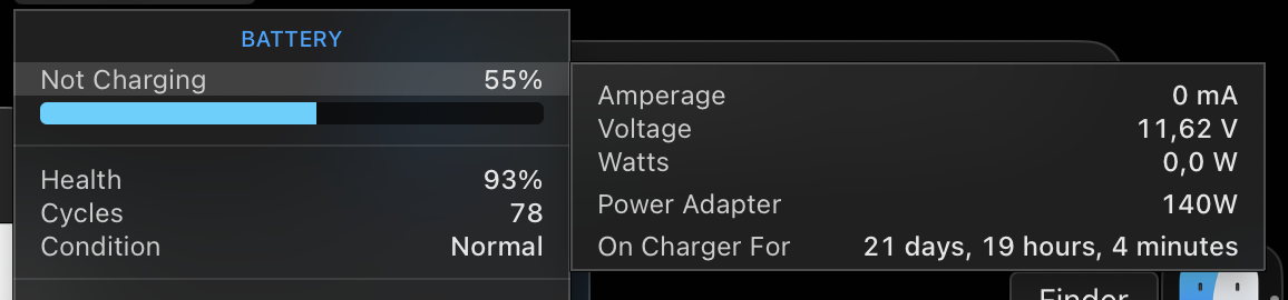

  • MBP will use more powerful charger, so if it provides more than 94W, it will be chosen as power source. You can check which power source is used in System Information > Hardware > Power (AC Charger Information) or with iStat Menus:
    But both power sources should be connected before powering up. It may not switch to your AC adapter if you connect it later.

  • MBP will use more powerful charger, so if it provides more than 94W, it will be chosen as power source. You can check which power source is used in System Information > Hardware > Power (AC Charger Information) or with iStat Menus:View attachment 2587480

Brilliant. Just connected the MBP charger and have confirmed as above that the Ultrafine is no longer delivering power so seems no need to buy a TB dock after all. Thanks!
