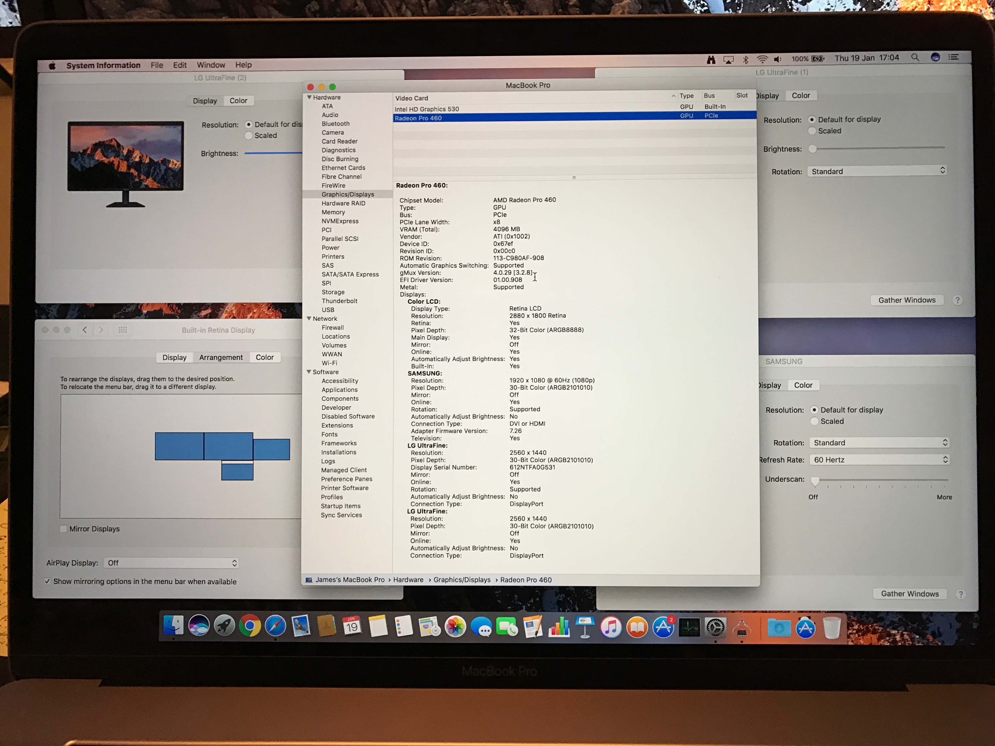

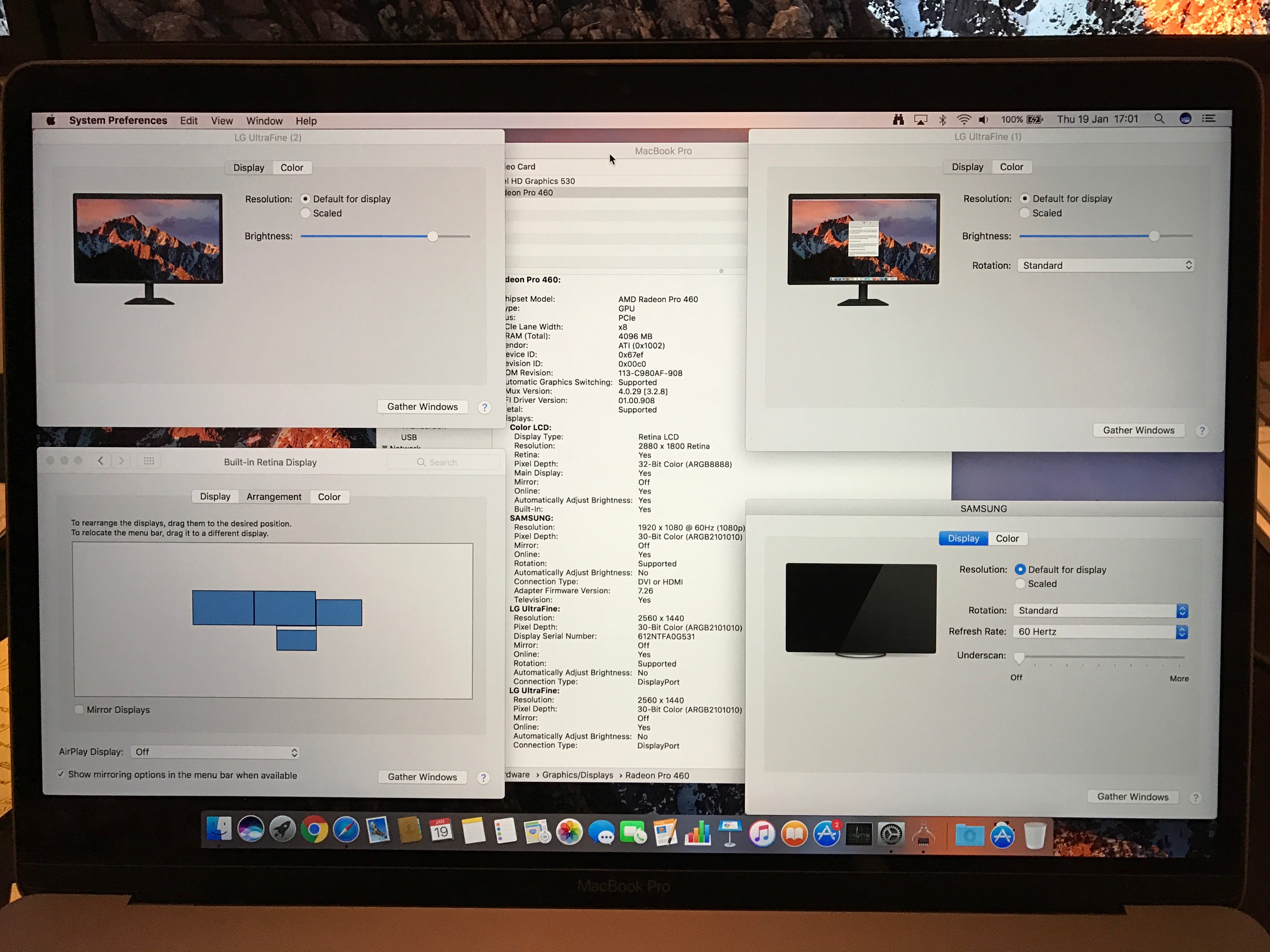

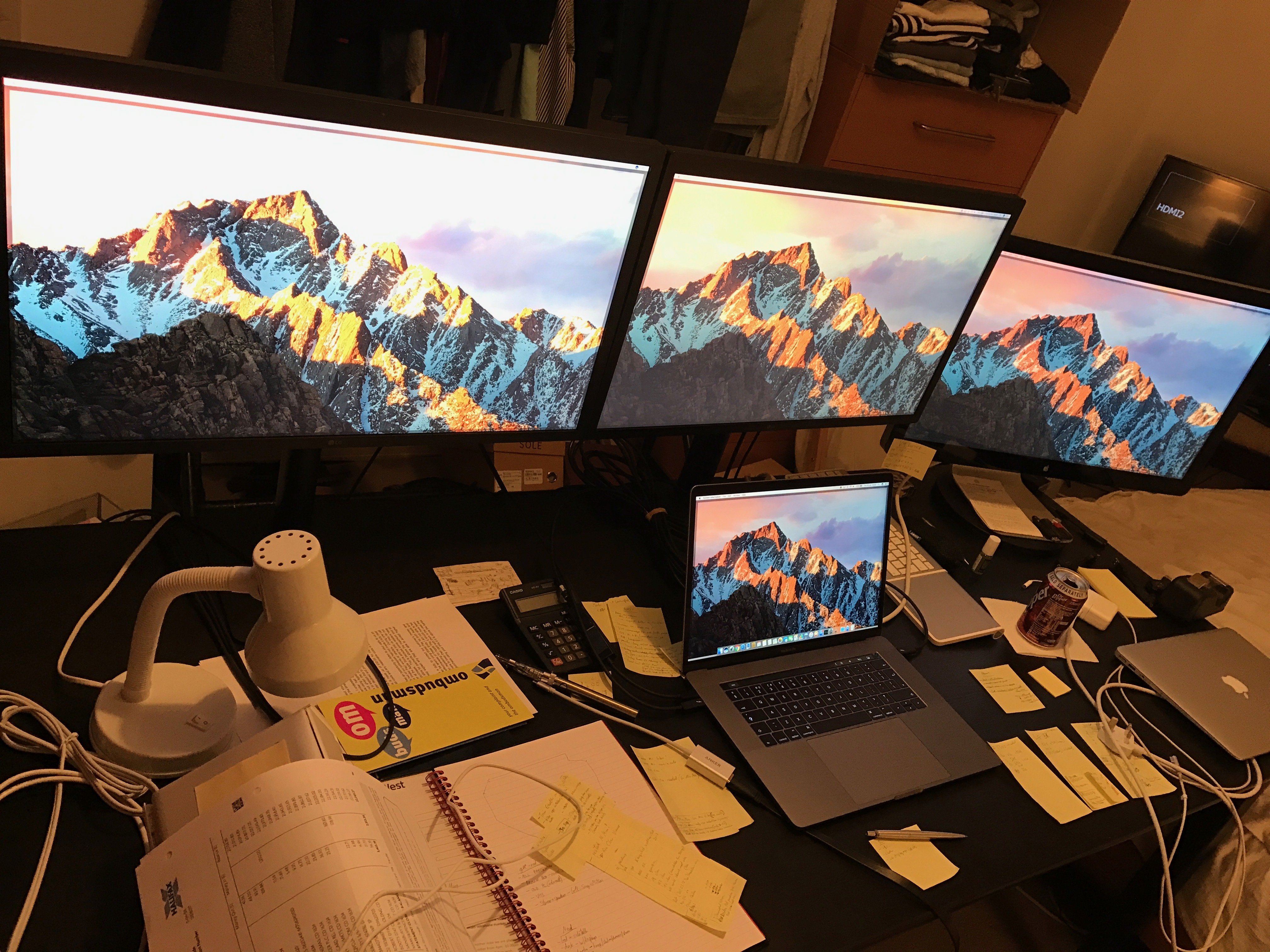

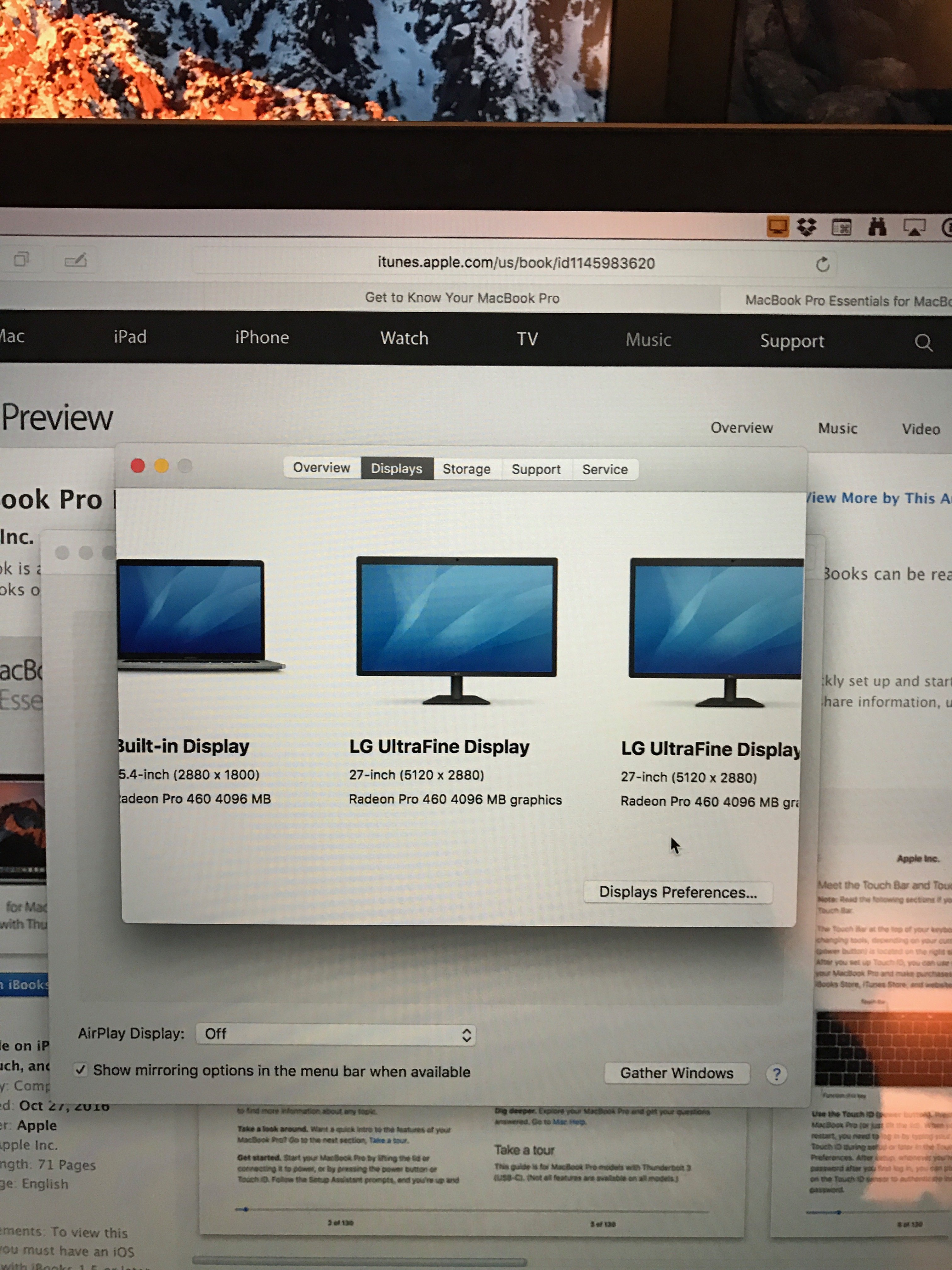

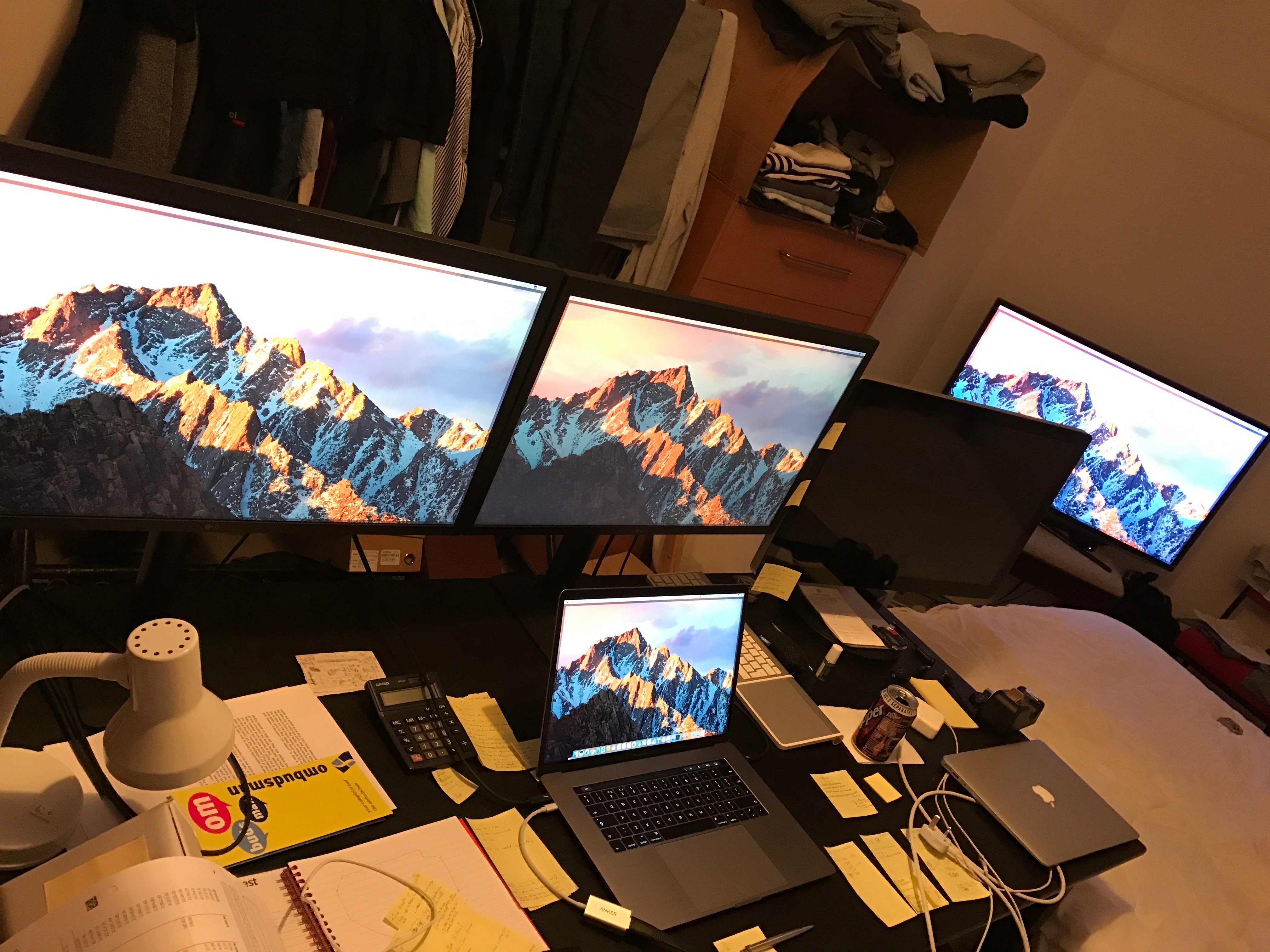

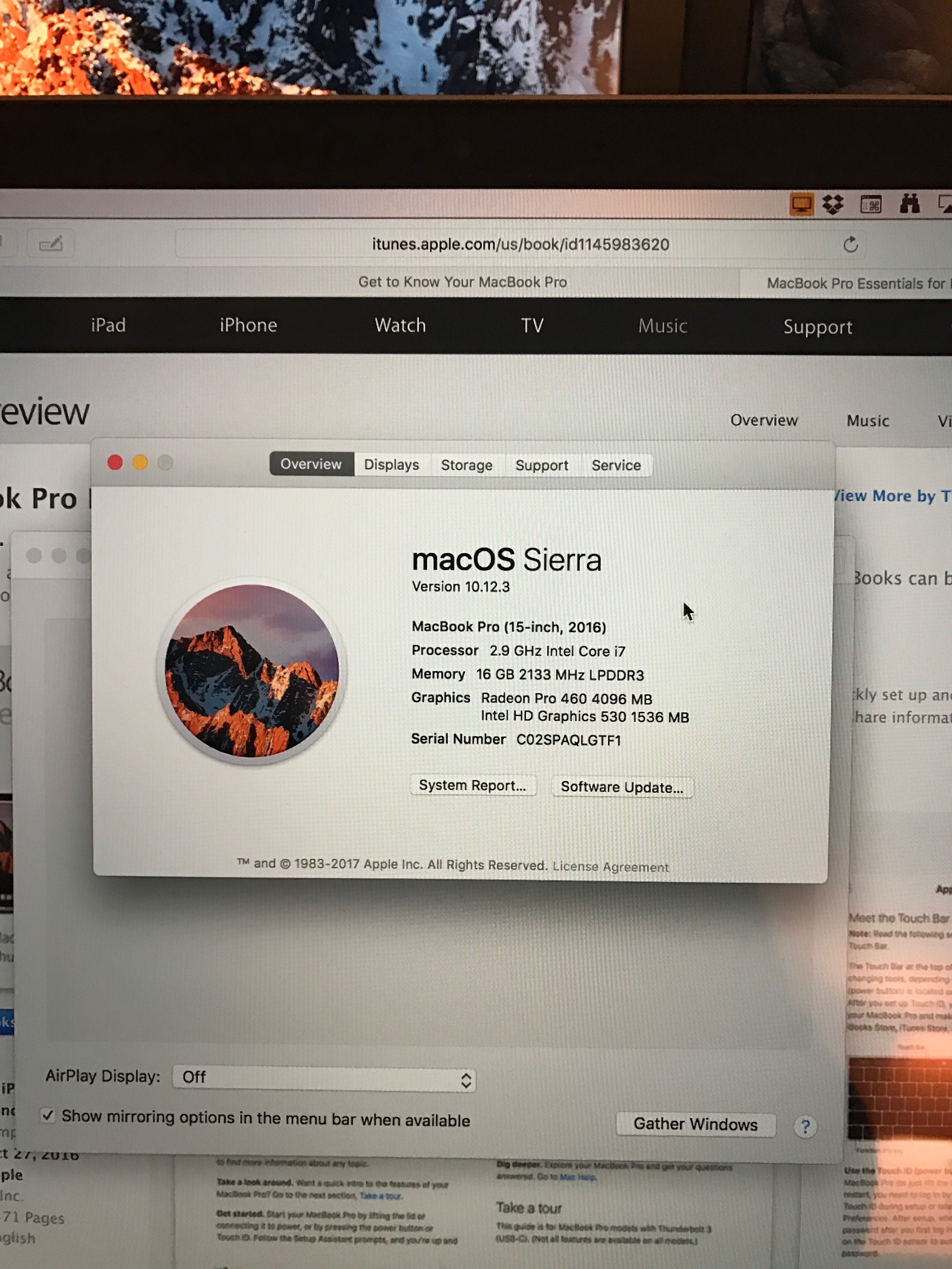

Not a detailed review (as we pretty much know most of the pros & cons about these by now), but a few images/videos concerning the 460 GPU's power, I found when I initially tested them (on macOS 10.12.3).

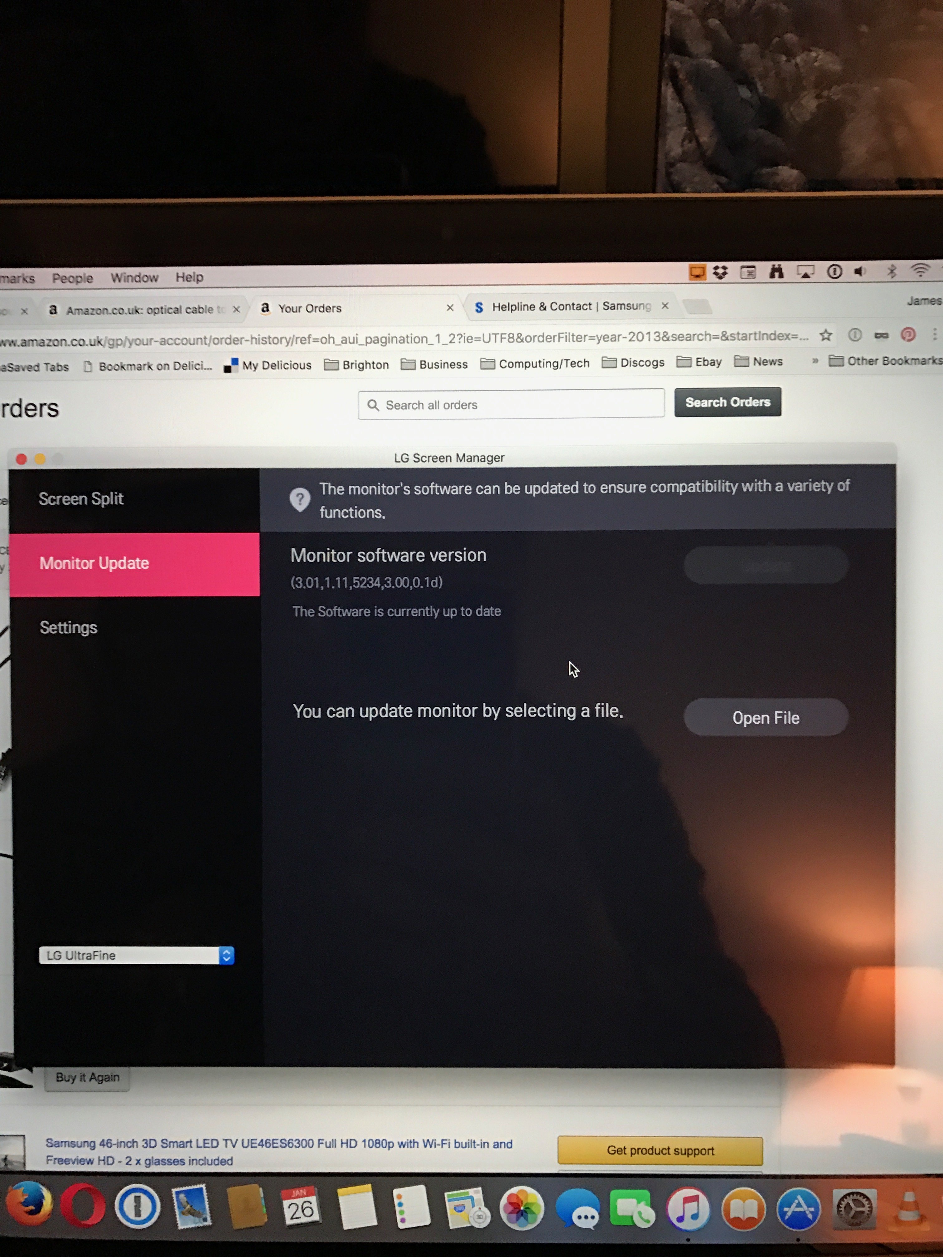

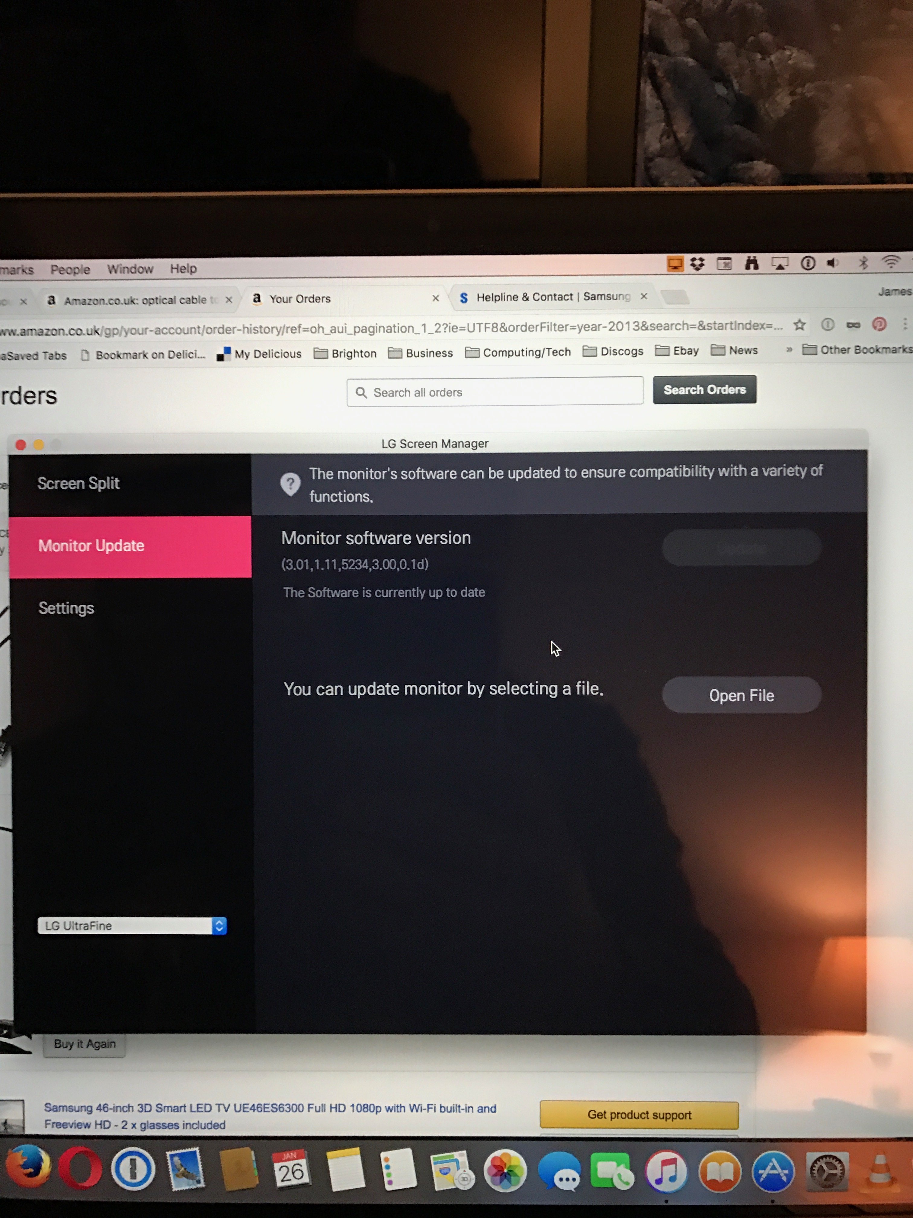

1) LG screen manager SW version:

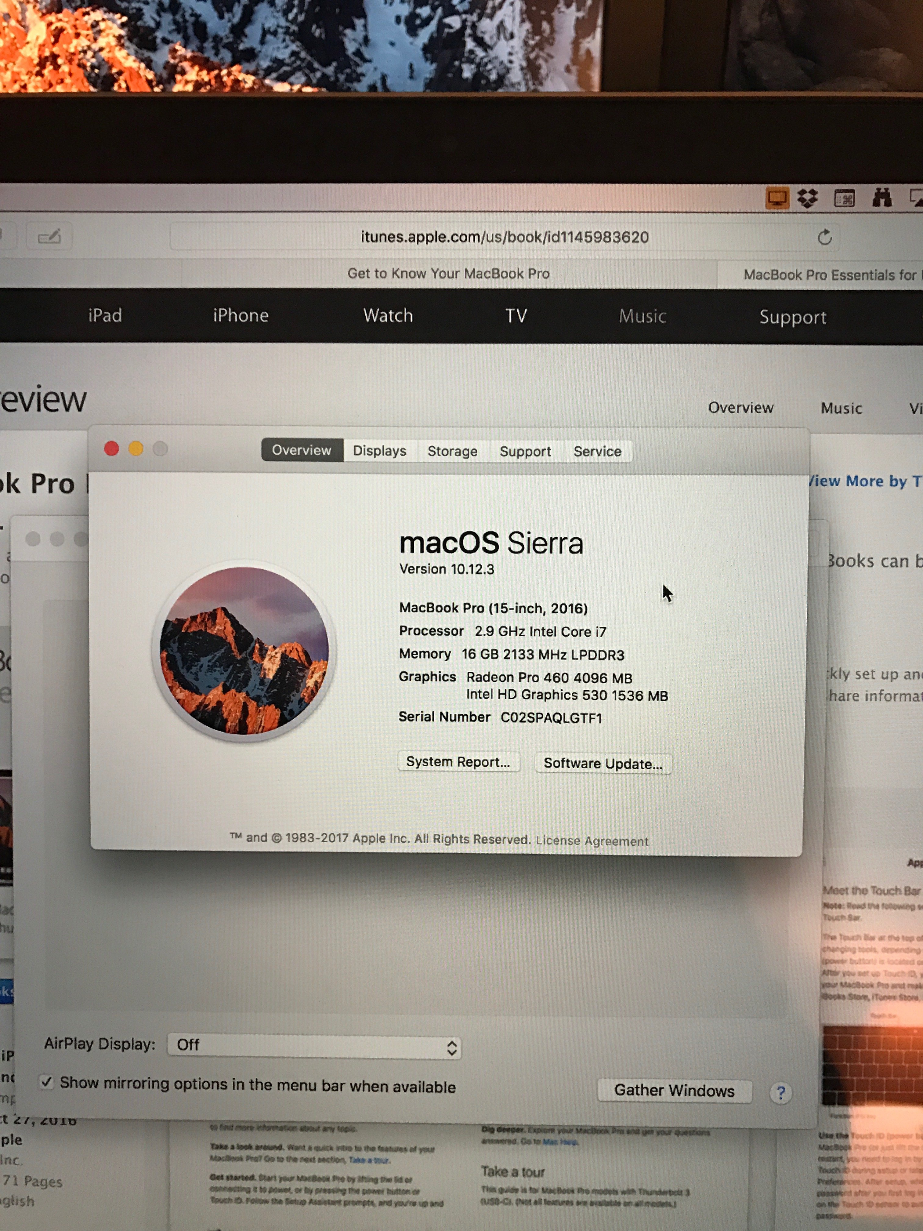

2) "About This Mac", OS version: ------------------ 3) "About This Mac", Displays connected:

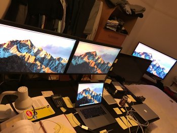

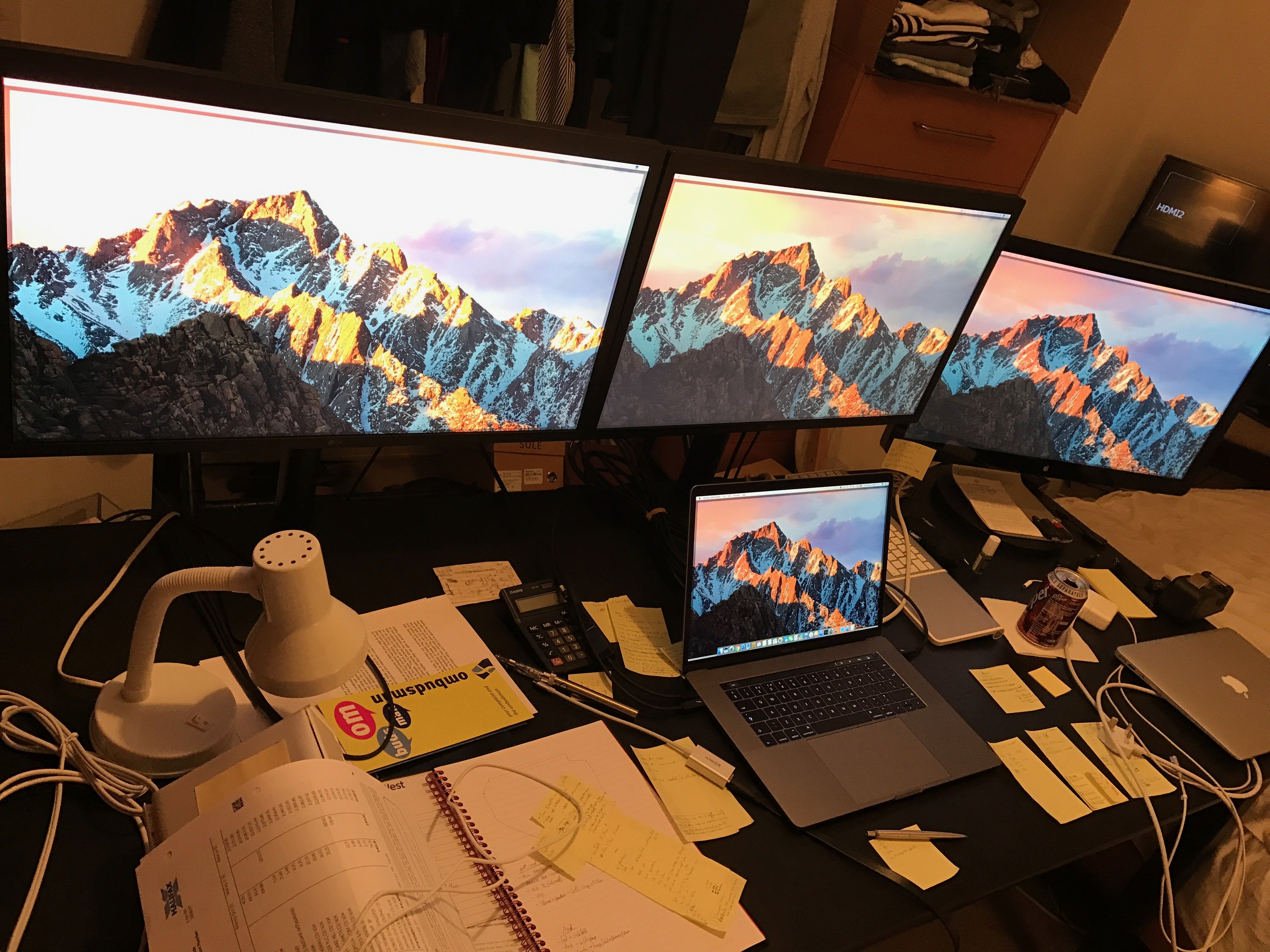

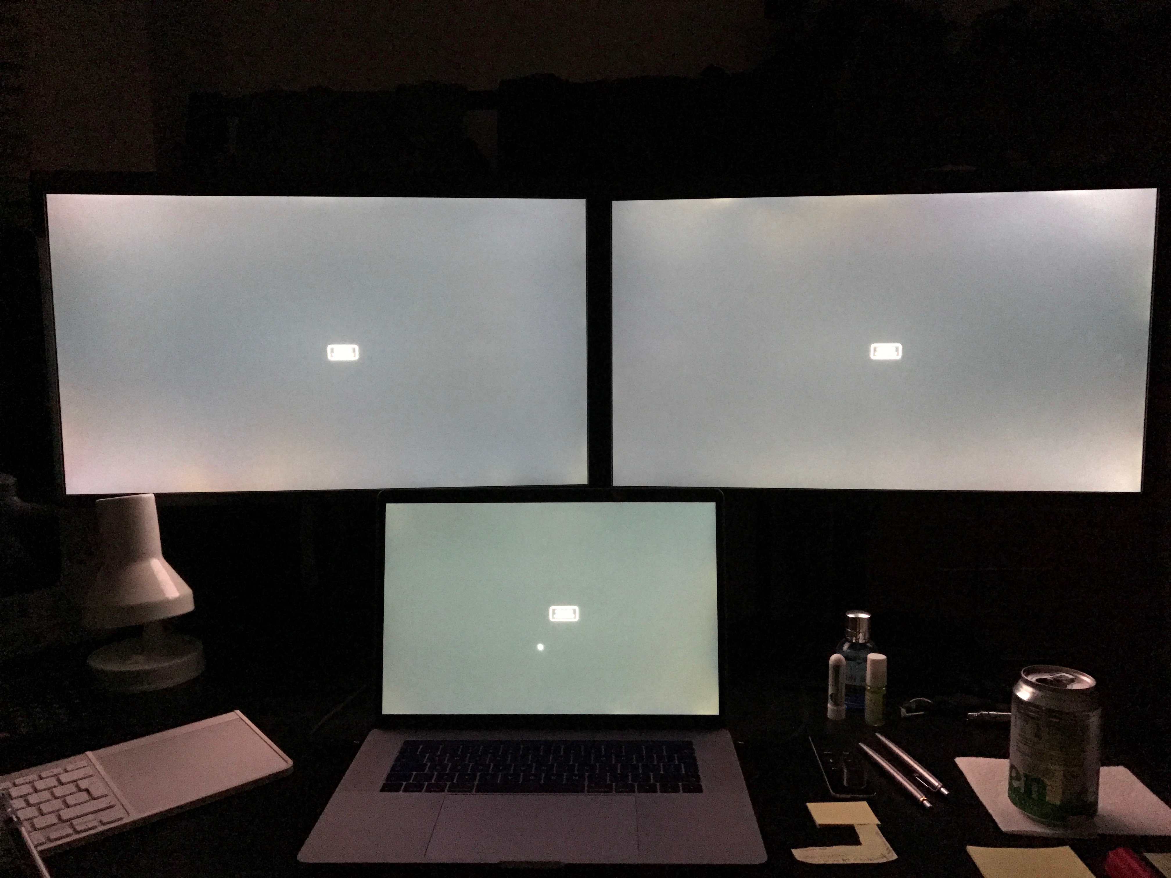

4) MBP + 2x LG screens, in light (mid brightness): ---- 5) MBP + 2x LG screens, in dark (full brightness):
6) Thunderbolt 3 cable, bag code: ------------------ 7) power cable, bag code:

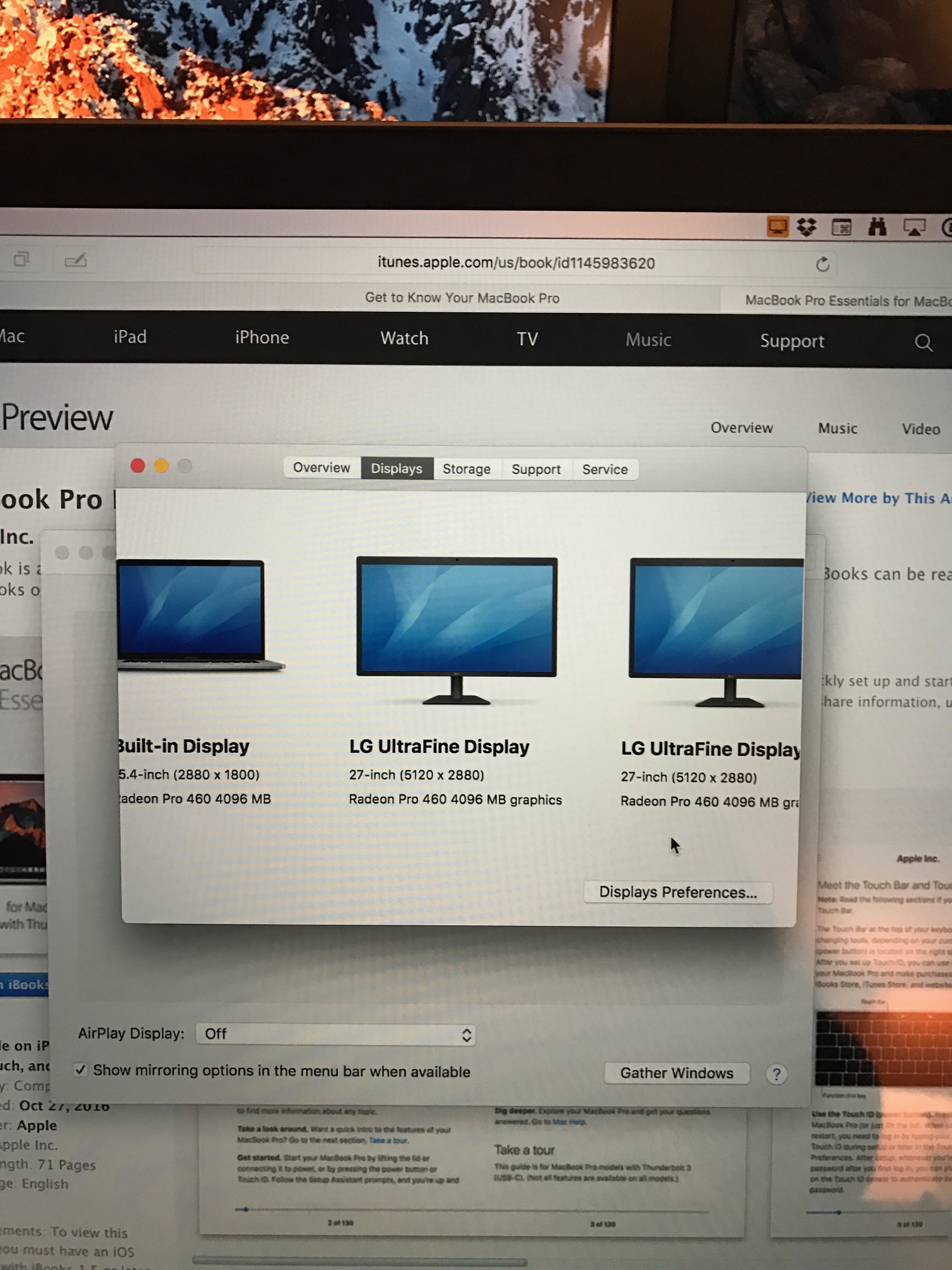

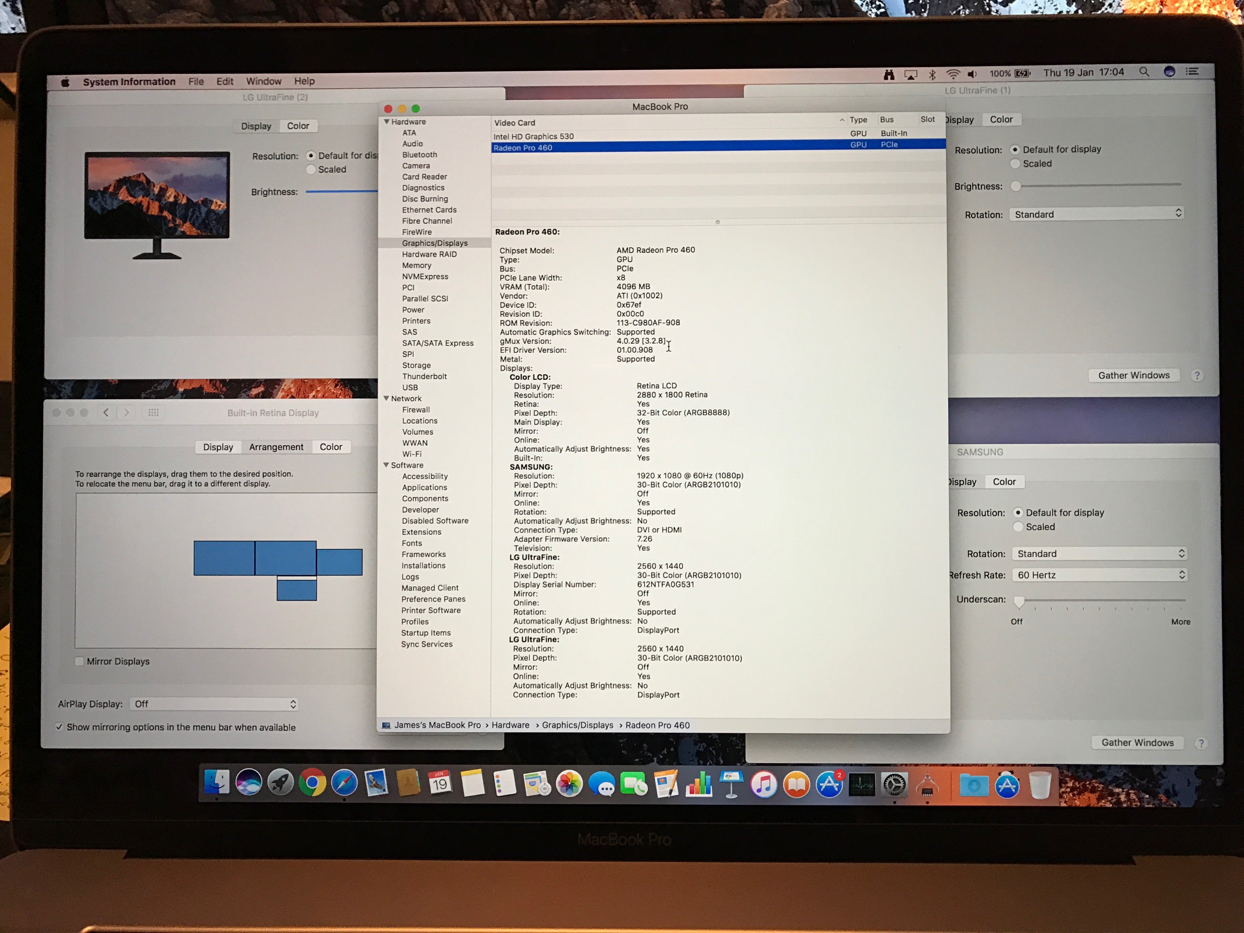

8) Sys Prefs (Displays), MBP+2LG+1FHD: ------------------ 9) Sys Info, MBP+2LG+1FHD:
10) MBP+2LG+1FHD displays connected:

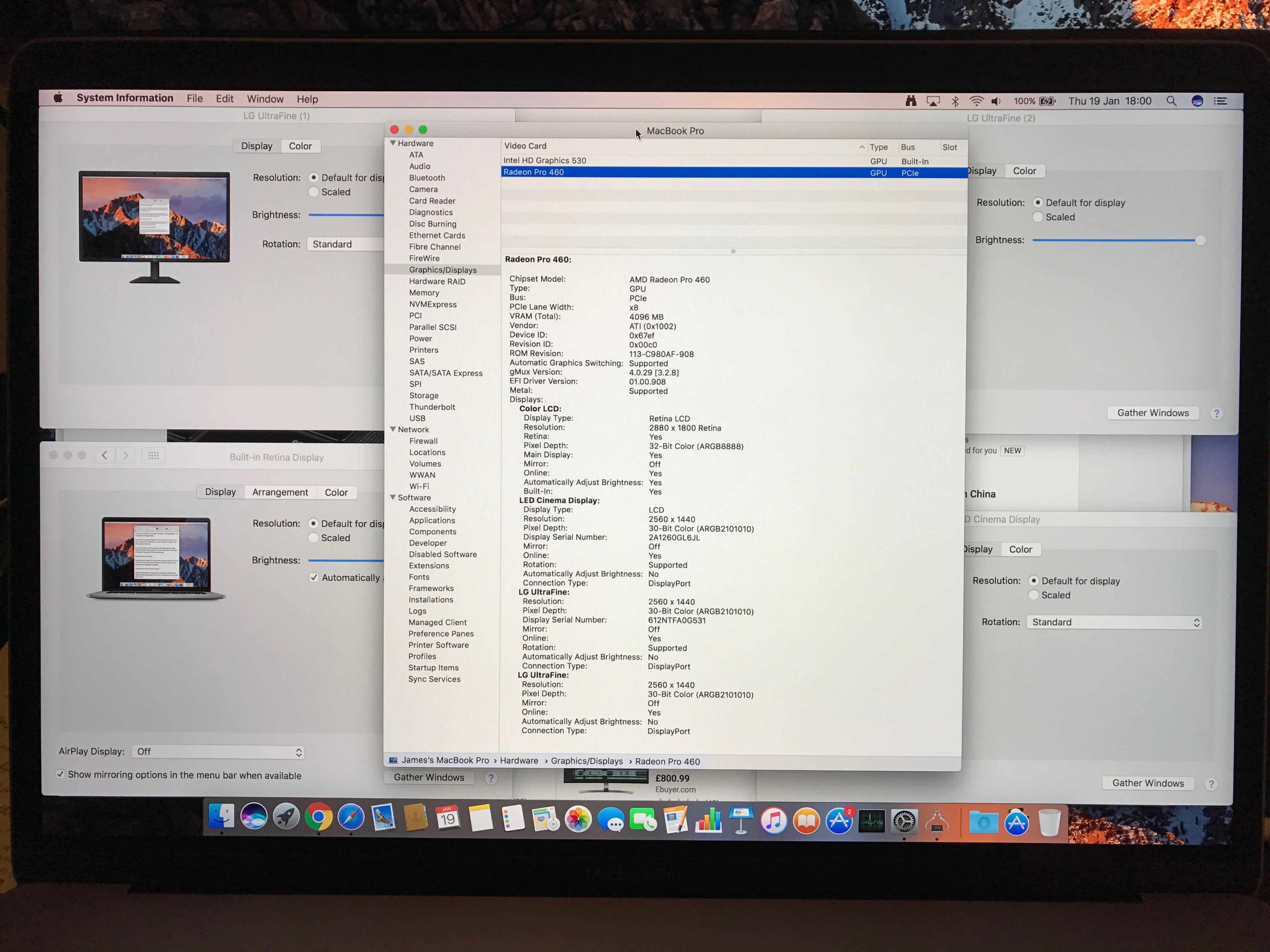

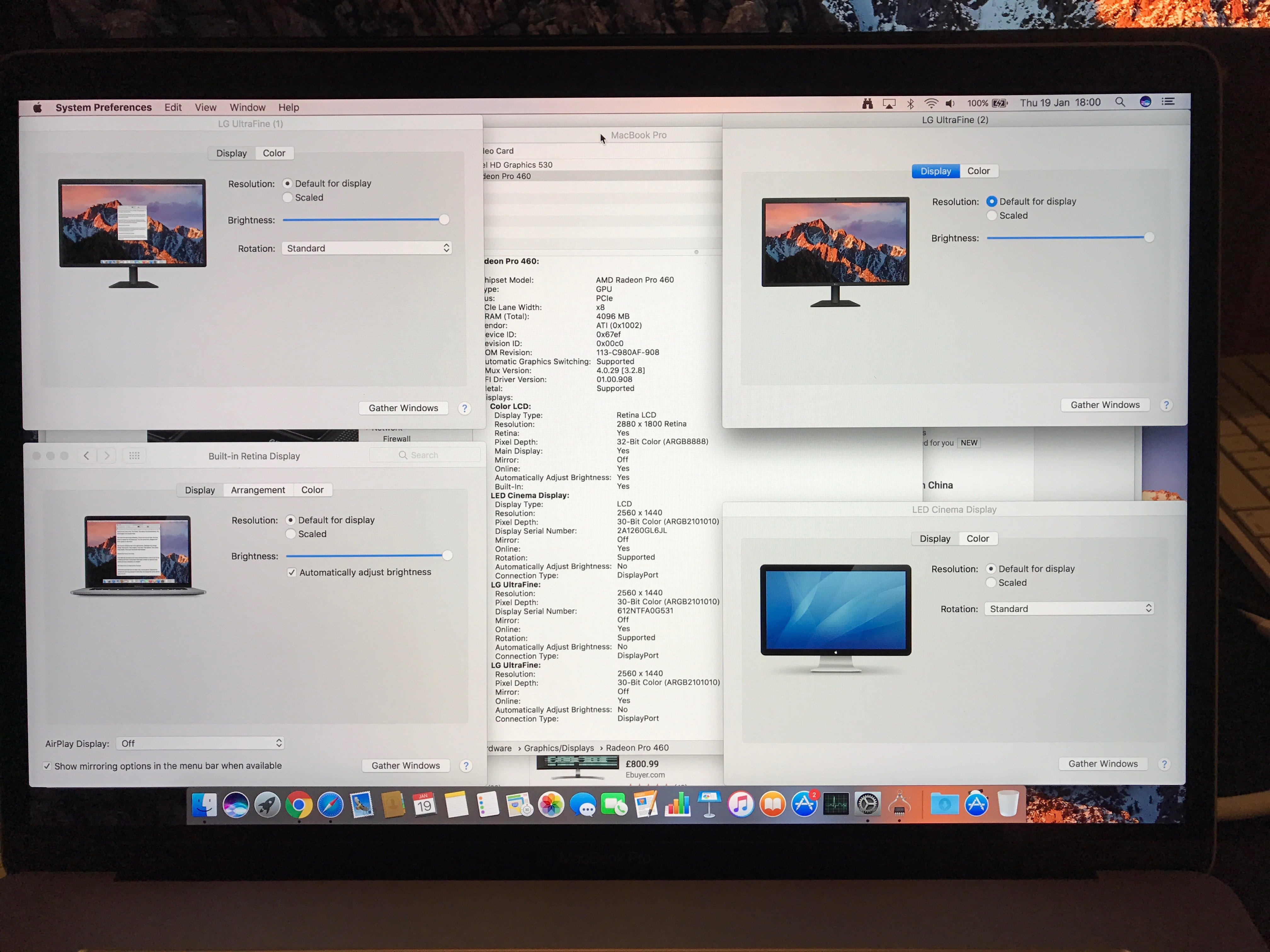

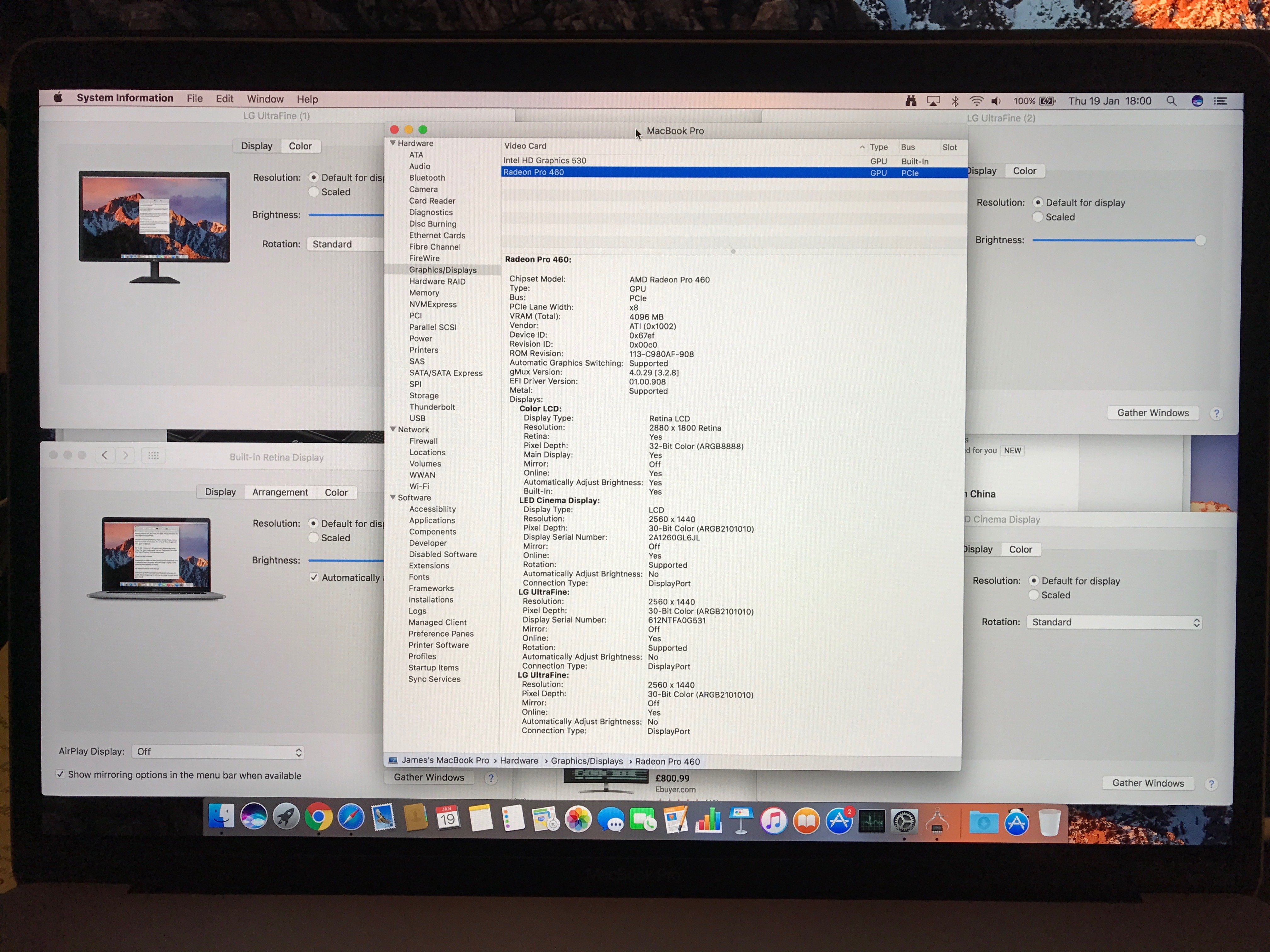

11) Sys Prefs (Displays), MBP+2LG+1ACD: ------------------ 12) Sys Info, MBP+2LG+1ACD:
13) Displays connected, MBP+2LG+1ACD:

D) 4 screens: MBP+2LG+1ACD – BLACK IMAGE (mid brightness) [NB: the ACD is on the LEFT side!]:
E) 4 screens: MBP+2LG+1ACD – BLACK IMAGE (full brightness) [NB: the ACD is on the LEFT side!]:

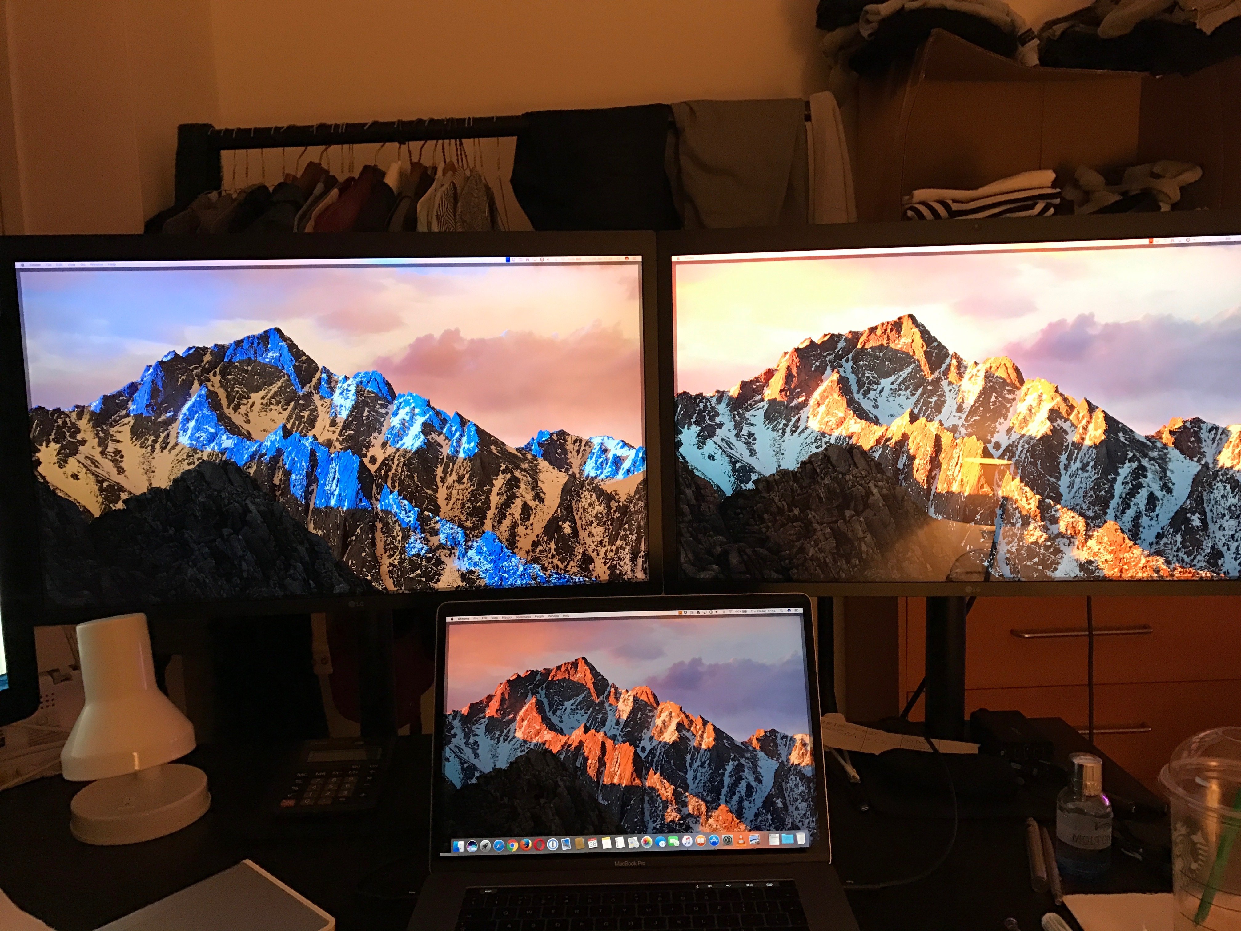

So I managed to get F O U R (!) screens going at once from a maxed-out 15" MBP (2016). The only thing to note is that, running 4 x 4K YouTube videos in fullscreen EXTENDED display mode caused buffering issues, and this is media streaming from the Internet rather than local, so more demands are being placed on the GPU and the network, obviously. So with local media, at various encodings, one may get completely different results which I haven't tried.
The total load was:
- MBP screen: 2880 × 1800 = 5,184,000
- LG 5K #1: 5120 × 2880 = 14,745,600
- LG 5K #2: 5120 × 2880 = 14,745,600
- ACD: 2560 × 1440 = 3,686,400
= 38,361,600 pixels (or ~38.4 megapixels).
Incidentally, the fans sound REALLY loud in the vids, but mostly that's the iPhone 7 Plus's mic making them sound so loud. Yes, they are making a decent amount of noise, but they don't sound quite that loud in reality. But really, running a heavy GPU intensive task such as this is obviously going to push them to their limits.
Though, it's certainly interesting just how powerful the discrete GPU is (as it runs all of them not using the integrated one at all), at least on the maxed-out 15" model with 460 GPU. ;-)
