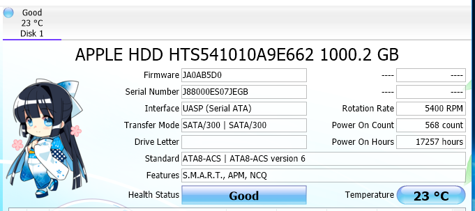

I have two 2.5" hdds from mac mini server that have 17257 power on hours each. This converts to almost 720 days of non stop usage and both drives still run just fine.
