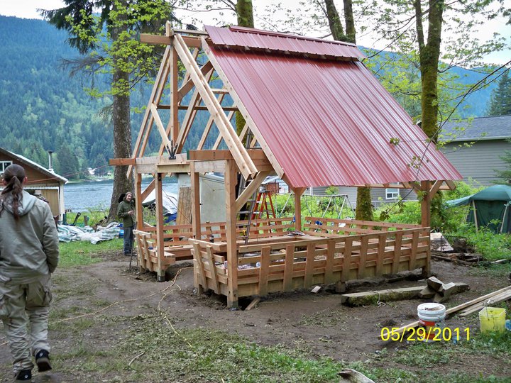

One of the traditions at the place is spending the evening at the campfire drinking and making fun of each other. There are some pictures here and there of campfire shenanigans, but they are all camera phones pictures. I figure it'll be fun to shoot with my 600D, 50mm f/1.4 and a flash to augment the firelight. The campfire has a wood structure over it to protect us drunks from the Pacific Northwest rain.
This picture will give you an idea of what it looks like:

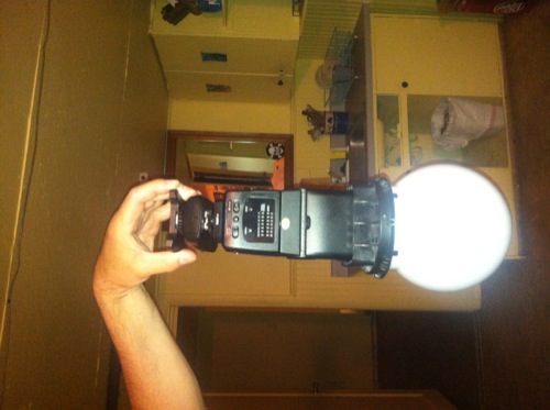

I was thinking I could hang a light from the center of the structure, right over the fire. I figure I could wrap it in saran wrap to protect it from the smoke, then hang a bit of cardboard directly under the light with a layer of aluminum foil on it to block the heat from the fire. This would be the light setup (I dunno why the picture of off 90º, it is right on my computer):
Does this sound like a reasonable plan? What would you do? How should I gel the light to best match the firelight?

I would not even bother protecting the flash from "heat and smoke", but then again I treat my camera gear worse than power tools, so YMMV.
As for gelling it, I would bring 1/2 CTO and full CTO gels and see which gives better results.
Also, instead of hanging the flash, you might be able to bounce the flash off the wood ceiling, also eliminating the need for a gel..
Bounce your flash.... it'll be a bit more directional than just overhead.
I would only put a flash - protected as you have listed - above a fire if I was willing to lose it. Saran might melt. An ember may land on plastic and melt it.
I also wouldn't use my good camera during a night of drunken campfire shenanigans. Or at least be really disciplined about getting your shots, and then putting it away early in the evening.

I didn't think at all about melting the saran wrap, this is why I like to bounce these ideas off people 😛 I wonder if I should wrap it all in foil except for the light modifier itself.
The reason I like the idea of hanging it in the center of the structure is to get somewhat even lighting around the whole place without shadows from the trusses. If I do end up bouncing off the roof then I can use both my LP160's and bounce on off each side of the roof and probably get faster recycling times. I haven't been up there since the new structure was built so I don't know what color the underside of the roof is, and how that'll effect the color of my lights.

Seems like a lot of risky business for no gain.
The firelight will be more interesting than direct flash from above.
Enhance most of the shadow details by a SMALL amount of bounced flash from the roof, and tack a large piece of white card under the roof timbers. The card is expendable and cheap. If it is possible, paint the underside of the roofing metal instead. Matt white. Good for many sessions.
Pick the best spot for your photography and put the card above your shooting position. Use several if you are moving around. Use several anyway.
Under-light the scene for effect rather than wash it out.
If the 'shenanigans' turn pornographic, forget fancy lighting, use direct flash and keep the camera lens dry in the close-ups 🙂

I agree with this 100%. Flash from above as a key light will create what is usually referred to as "monster lighting," which may be an interesting effect for a shot or two, but I don't think you're going to want it for the whole series. All you'll need is a bit of fill from the flash(es).
You're probably asking for trouble by wrapping the flash in anything. It could overheat or something. So just keep it on your camera and bounce it or else keep it on a lightstand/tripod and bounce or fill from there. Does your flash have a bounce card built in? That sort of modifier could be perfect for this situation, giving you some fill from above and from the level of the flash at the same time.
For firelight, I reckon you'll need full CTO, but definitely bring along an assortment of gels if you have them.
Buy a cheap manual flash you can let melt worst-case instead of risking a good one in less than ideal conditions.
