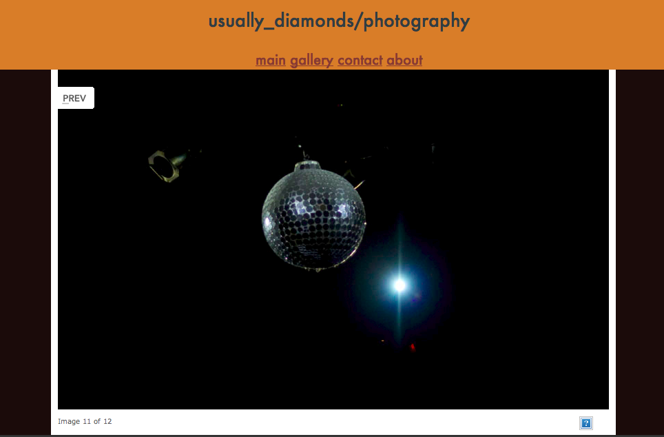

Hello, I've been using Lightbox2 on my website. However, for some reason, the Close button that's supposed to appear at the bottom of images won't appear. I am pretty sure everything is in the right place in terms of files since Previous and Next appear in images; Close just won't appear (it gets the Question Mark sometimes, or nothing at all). I tried replacing the files with images I made that are the same size to no avail. One weird thing is clicking in that area does close the image, button the graphic itself doesn't appear. I've using version 2.04, the current one. I can post code if needed.

Sorry, it's back under develop ATMO, but I've attached a picture. You'll see the "Prev" image but below at right there's only the question mark.

right click on the close button (or the broken image thing) and copy the image location. Then paste that into the address bar and see where it takes you. Your image location is wrong, that will let you fix it.

I looked at my remote site and the close and closelable.gif had not been uploaded. I uploaded them and things work fine.
