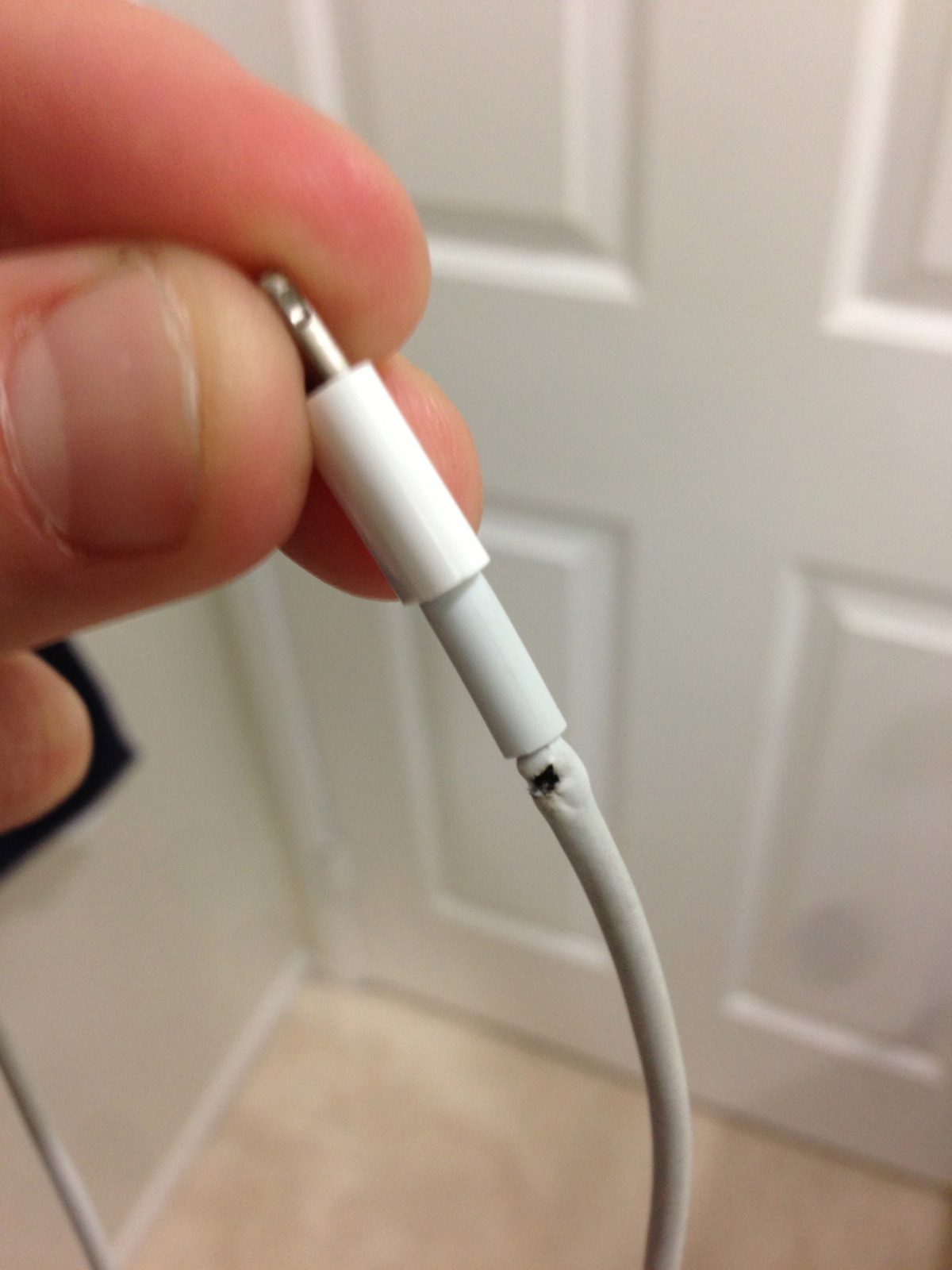

Alright guys I tried to get a good shot of the burn area, it's very odd honestly.
I've gone through two lightning cables for my iphone 5 since launch day, and tonight my second one actually short circuited and started smoking while charging my phone. In my opinion, this is the worst accessory/product I've ever owned. I hate the lightning connector with a burning passion.

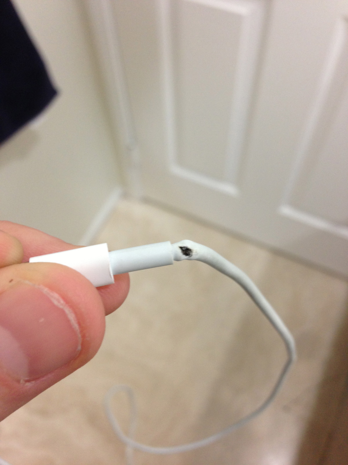

The cable used by Apple in its leads is the standard variety (Apple don't manufacture cable!) which has a PVC sleeve. PVC is not particularly flexible and, if submitted to continuous bending or flexing, can fracture. For this reason, when the relevant plugs are inserted/removed from their appliance, the cable should only be held by the plug. In addition, bending of the cable adjacent to the plug should be avoided as this creates stress on the cable sleeve.
The photos submitted by the OP clearly illustrate the above faults. The cable has obviously been bent close to the plug which has resulted in the fracture of the cable.

I want to be clear that it wasn't bunching up. It looks like that from the plastic expanding when it had sparked and started smoking.

It looks like you manhandled where the wire goes into the lightning end and that might have done something.
But I didn't. As I stated previously it looks like that from the spark and smoking that came from the wiring inside the plastic outer sleeve. The hole is from the spark burning through the sleeve, not from bending or stretching.

I've had loads of customers at work come back with lighting leads which are faulty never had it before its strange they all seem to baulk just below the lighting head like in the photo above
