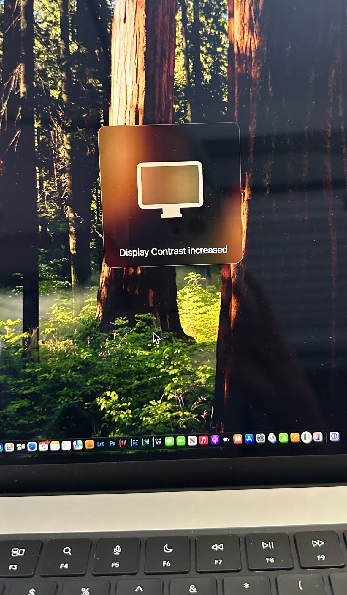

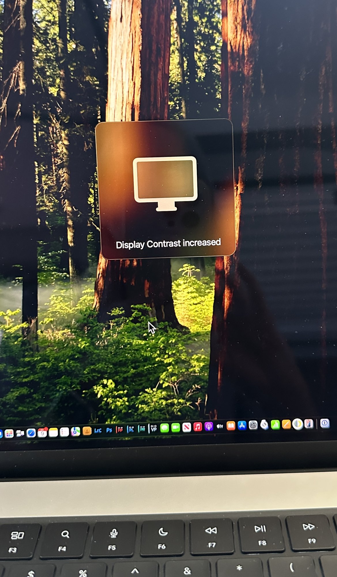

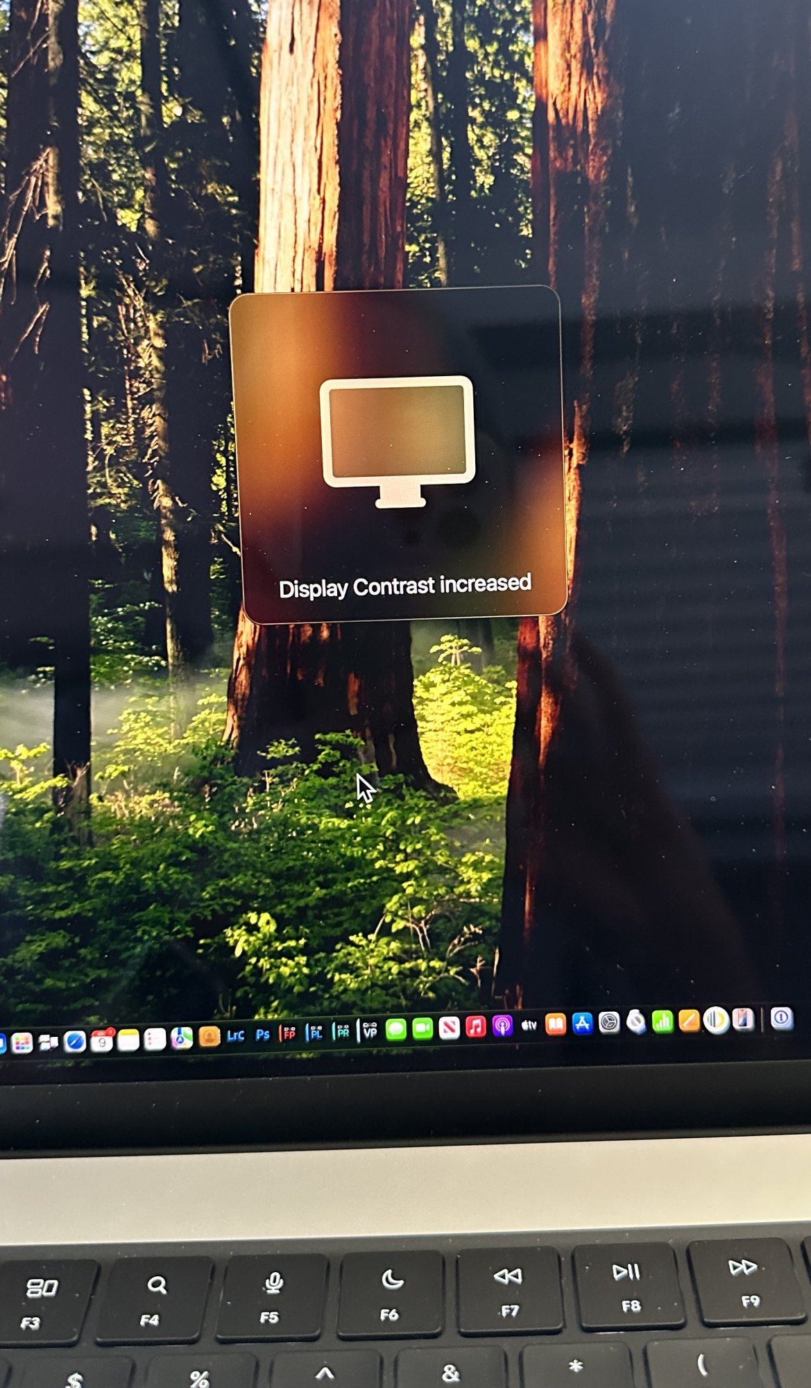

However, I had noticed something when I started up both the M2 and now the M4 that I wondered about - I get a quick notification on the screen as the computer is starting up that says something about increasing contrast.
I have no idea where that came from, it appears and then disappears quickly. It does NOT appear when I switch to the second user. I first noticed it when I was setting up the M2Max computer and while I found the additional contrast annoying, it wasn’t enough to bother me. At the time I had an X-Rite i1Pro calibrator and it’s i1Profiler software. At the time the calibrator didn’t work on the M2Max computers and I never tried to use it later on - I ended up buying the Calibrite.

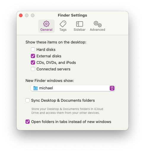

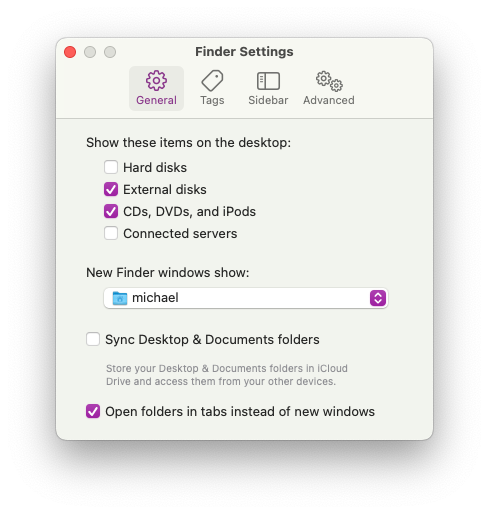

The HD on the desktop is a Finder setting that is no longer enabled by default.
Awesome!!! Thank you SO much - I’m delighted to find that. I’m finding that as time goes by, things get more complicated with new menus etc. and I don’t always find them. I had never noticed this before.
