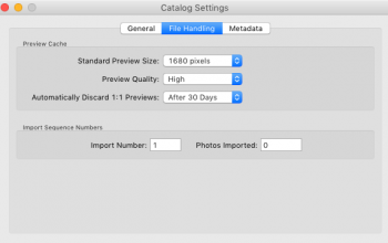

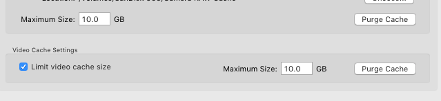

Preferences: File Handling and Catalog Settings: What's your Preview Rendering Quality setting? What's your RAW cache folder setting? See my attachments. Don't purge stuff more than you need to or it'll slow down your workflow. I only discard my 1:1 HQ previews after 30 days because I "develop" within a few days of importing. YMMV.
