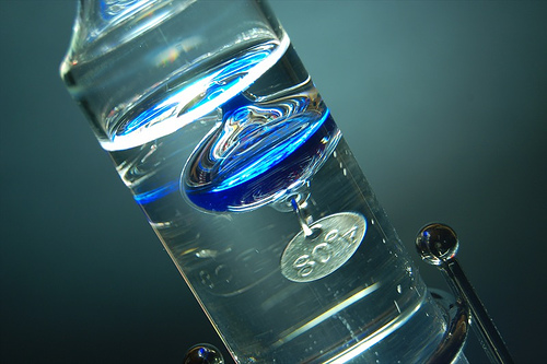

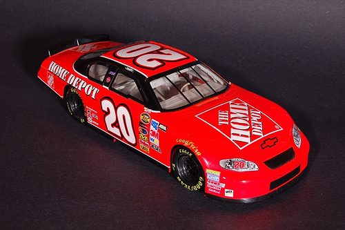

2 Work lights (w/ clamp) from Walmart with those new GE Truelight 100W bulbs. $15
1 Old TV Tray $5
Black poster board $3
WB setting on digital Camera
Worked out nicely for this. My Main light is 45* on right side about 4 feet away. My fill is behind the camera about 8 feet.
I has a flourescant shop light on the table facing up for this one.
Give it a shot and see how it works for cheaper before you buy the full set. You might be amazed on what you can learn by using stuff around the house. LOL
