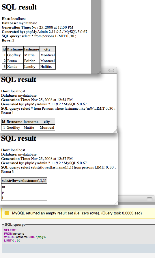

hi lee,
it just doesn't seem to work...
as proof, i've attached a print out of my sql queries and returns. you can see the full 'persons' table in the first print, and the last print you can see that it returns no results for like '[mpl]%'...

it's so weird! every other basic query from my studies works except [charlist]... i'm sure i could live with that, but i'd just like to know if it's something i'm doing wrong or not...
could this be just simply not be supported with MyPHPAdmin?
