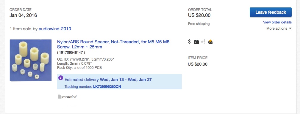

here are the washers I use . They are made of Nylon 66 , which is a pretty safe plastic around electronics .
OD = 7 mm
ID = 5.2 mm
Length = 2mm
The seller no longer stocks them .
