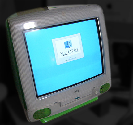

So, I have a computer that I could NEVER part with:
My Lime iMac G3 333 with 6g hard drive and 288mb of memory, Mac OS 9 and well, that's about it. I'd use this computer for everyday fun if it had a browser that worked. Most websites won't work with Internet Explorer 5.1 (too old). I've looked into open source browsers but they don't support the dated OS. Since (as far as I know) the ancient hardware cannot be upgraded to OS X, I cannot upgrade the browser for it and I have no clue if Linux would even work on this system. I'm not sure how to make this Mac useful again. Most would throw it on the streets, but I'm other than the fact that I've become attached to it, I'm too tree-hugger to toss it.
Also, if anyone has an idea on what to do, since it's not wireless and has usb 1.0 and Ethernet, is there some sort of bridge I can purchase (I'm not sure what I'm talking about) to make it wireless? I don't know if anything is compatible these days, but I'm willing to purchase something older.
Well, the only reason I'm asking these questions is because I'm tired of seeing it in the closet. It would be cool to see Linux on it, but I don't know where to start. ¿What to do with my Bulbous-Lime Green-40lb-Lead-Filled-Plastic Jewel?
If you want it functioning as a Mac, it should be able to run any flavor of OS X up to 10.3. The 6 GB hard drive is a limiting factor though, so it would have to be an awfully stripped down installation.
You can bump the RAM as well to improve performance...some machines of that model maxed out at 384 MB, while others could go to 512 MB.
Upgrade the RAM to 512MB (maximum for this system) and put in a bigger HDD. You should be able to run OS X 10.3 and if you do a little bit of XPostFacto, OS X 10.4.
iUbuntu?
Ubuntu it. Every bit of hardware in there will work from the install disk.
Could you/Would you point me to a website that will help me figure out how to install Ubuntu on a Mac? When I goto www.ubuntu.com I do not see information about Mac hardware. Mac OS X is great, but it would be like putting Windows Vista on a Pentium 2 machine. I have NO experience with Linux, so reading complicated forums and hacking things to make them work are going to cause too much frustration.
