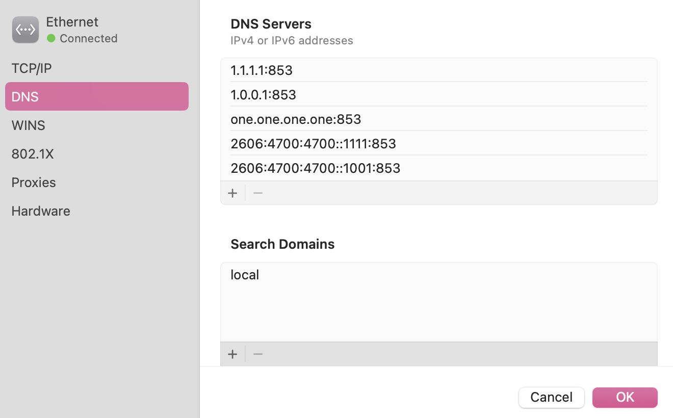

Maybe you need to add the IPv6 addresses and the alternative IPv4 address too.
I turned off IPv6 in my router but added them because if on mobile data it can't be turned off in iOS I think. Not sure if the app you are using is doing this anyway.
IPv4IPv6
1.1.1.3
1.0.0.3
2606:4700:4700::1113
2606:4700:4700::1003
I don't need blocking because it's in my VPN and Adguard. If you add :853 at the end of each address it should also use encrypted DNS over TLS.
I am using this configuration on all my devices and also in the router just to prevent using my providers DNS in any case.
Not sure what "Search Domains" is, I always replace what's in there with "local" because someone told me, but it's not really important to change it at all I think.
You could try the same with Adguard DNS too. There is a profile for iOS and macOS or you can just enter it also manually. The addresses arelisted in the Linux configuration. It's everything for free in Option 2, then you don't need to purchase Adguard.
Family protection servers
AdGuard DNS will block ads, trackers, adult content, and enable Safe Search and Safe Mode, where possible.
IPv4:
94.140.14.15
94.140.15.16
IPv6:
2a10:50c0::bad1:ff
2a10:50c0::bad2:ff
Adding :853 should use the TLS encryption here too. It's also all listed there at the bottom.
