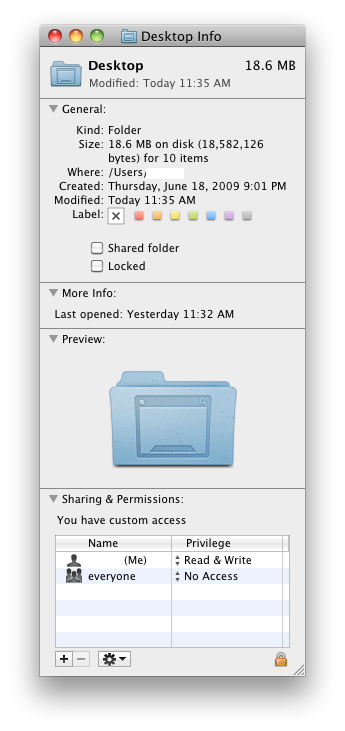

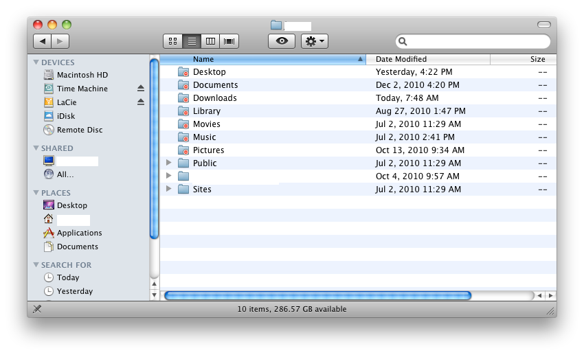

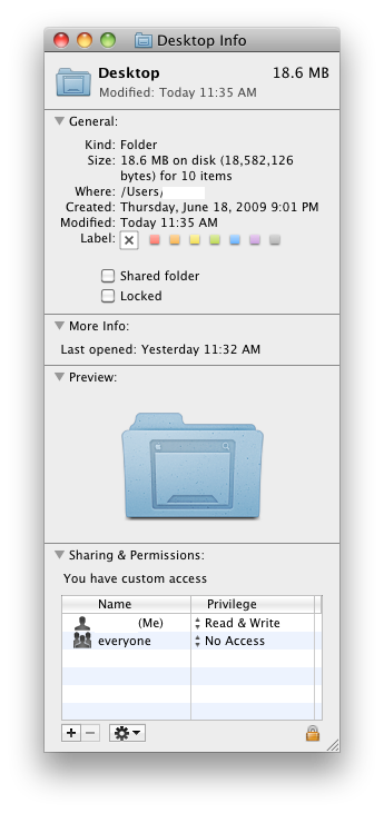

I just created another Administrator account, and when I logged on with it and tried to view my normal account's home folder, I could see that there's a desktop folder, but I had no access to view what was on it.
You'll need to right-click on your Desktop folder (logged on as you), Get Info, and check the Sharing & Permissions area at the bottom. Mine says that I have Read and Write, and Everyone has No Access.
If yours is set differently, try setting it to that and see how it goes. Same idea for your external drive.
