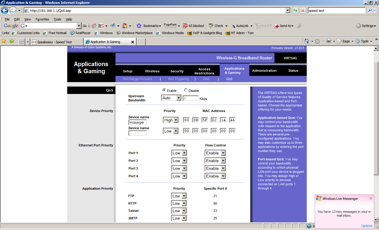

A standard/average router can't usually do this. You need a router with traffic shaping options. I think Linksys calls it Quality of Service or QOS. See if you have a tab for that.

I did a quick google image search. This is sort of what you are looking for. Sorry I can't be more helpful.
