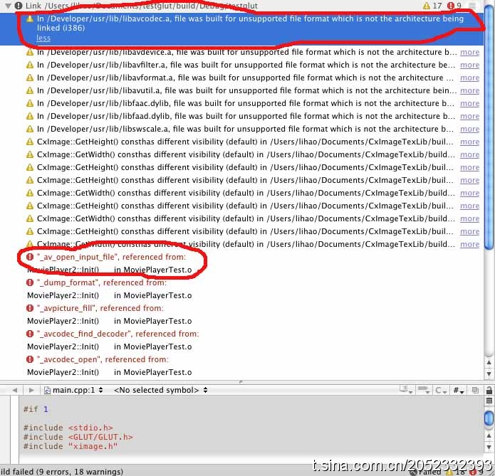

after that, make, make install. but when I use XCODE to link the libavcodec.a library, it always says:
ld: warning: in /Developer/usr/lib/libavcodec.a, file was built for unsupported file format which is not the architecture being linked (i386)
Undefined symbols:
whatever the the configuration is as i've mentioned , it leads to link error:
"_avcodec_open", referenced from:
MoviePlayer2::Init() in MoviePlayerTest.o
how can I do that?

yes, I read it carefully....
my problem is I don't know how to make it work together with ffmpeg and xcode in i386 mode....

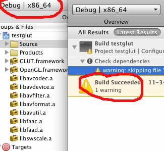

right now, i can link compiled ffmpeg( configure,make, make install) library with xcode in X86_64 mode, but I do not know how to make it work on i386 mode...
