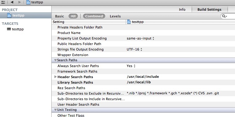

You haven't specified which version Xcode you're using but I'll assume it's some version of Xcode 4.x and point you at Xcode's "Source Trees" documentation. If you haven't already gone to "Preferences" -> "Documentation" and fetched the most current documentation I'd suggest doing so.
<file:///Library/Developer/Documentation/DocSets/com.apple.ADC_Reference_Library.DeveloperTools.docset/Contents/Resources/Documents/index.html#recipes/xcode_help-source_trees_preferences/About.html#//apple_ref/doc/uid/TP40010512-CH1-SW2>
Go into project settings and make sure that the header and library paths are included:
Don't tick recursive.
This is: -litpp -lfftw3 -llapack -lblas

THANK YOU!!!! This does the trick!!! Using command line in the command prompt is definitely way more straightforward.
What version of XCode do you have? yours doesn't look like mine at all in project settings...
