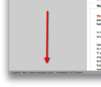

Maybe the links are linked to hard, meaning they still point to the files on the volume HDD and not the volume DVD-ROM.
Have a look at the links, do they look like this file:///Volumes/mydisk/index.html or more like this page1.html (pointing to a html document called page1.html, residing in the same directory/folder as the index.html).
You can look via Safari's status bar or in the files themselves.
