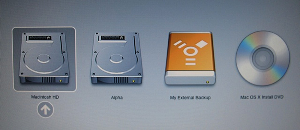

When I turn on the MBP, I click alt and select which drive (usb,hard drive,etc) to startup <- That is Mac's version.
I tried burning Windows and other Linux OS to a disc, and when I select to boot up from the USB from the selection menu, it just starts up the GRUB selection menu.

The screeny shows Apples boot option menu you aren't going to see you Linux partition there because it can only scan for apple bootable disks and that's not Linux.
I assume that you want OSX, 10, and Linux so start again this time don't use bootcamp partition all your stuff in OSX and install both Linux and Windows in EFI mode in the partitions you made. GRUB is going to kill the Windows bootloader because it can't boot from it but GRUB can boot Windows.
When you boot refind will stop the process and allow you to boot from you other partitions.
