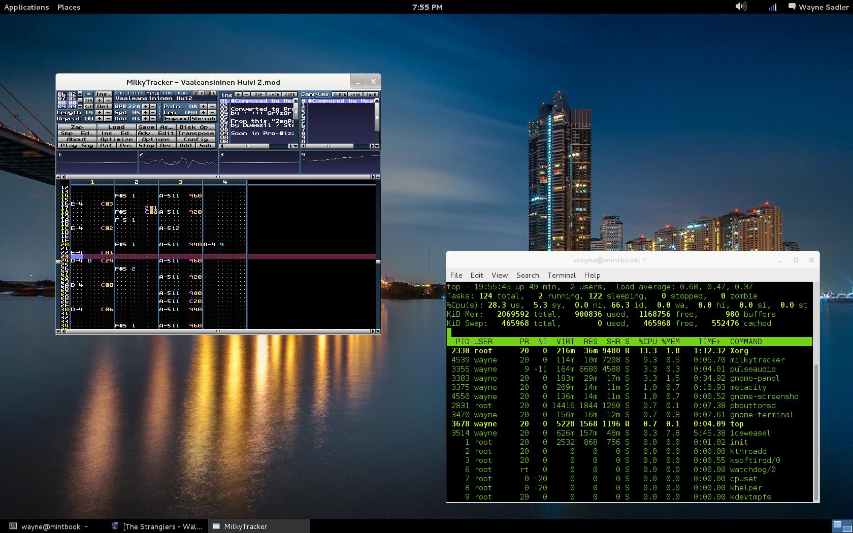

What Dronecatcher said x10. And:
Powermacs are getting old. Like, really old. Last one rolled off the line what, ten years ago now, and that's an eternity in computing time. The web is moving on and moving on fast. Even simple web pages are ludicrously javascripted to hell and back. This is all well documented on other threads in this forum. Which isn't to say Powermacs aren't useful, they still are of course, in lots and lots of ways. But, if you demand 720p youtube playback, save them pennies and buy a Chromebook. Or just stick with OS X, grab Coreplayer and download your 720p vid with PowerPC media center. I mean, its impressive as hell that we still can do that, ten years post Intelization. Thank you Dr. Cameron Kaiser, hope your honeymoon was awesome.
Linux...I've been using tux on PowerPC since MkLinux back in the late nineties. I am THAT old. It's awesome but its not a magic cure for anything, it will certainly not make the web less of a sh@t storm of bad code. OS X from the same era as the machine will always run better, be easier to install, give you less headaches. Apple are very, very good at what they do. Even worse, PowerPC Linux is poorly supported and doesn't have some of the uber lightweight options that x86 does. No LXLE, no Puppy, no AntiX, no ConnachaetOS, no Deli(cate). We are limited to Debian or Ubuntu with a lightweight window manager. MintPPC was by far the best of the bunch, but its Wheezy not Jessie, and not being updtated. Debian Wheezy has recently gone LTS, but...not for PowerPC. BooHoo.
Here is a recently posted video of exactly your Powerbook with Lubuntu 12.04, but loaded on a SSD. He does way too much talking and not enough showing of performance, but....I can definitely live with the snappiness of this machine. Problem is 12.04 is also getting old, and a year from now will have no support.

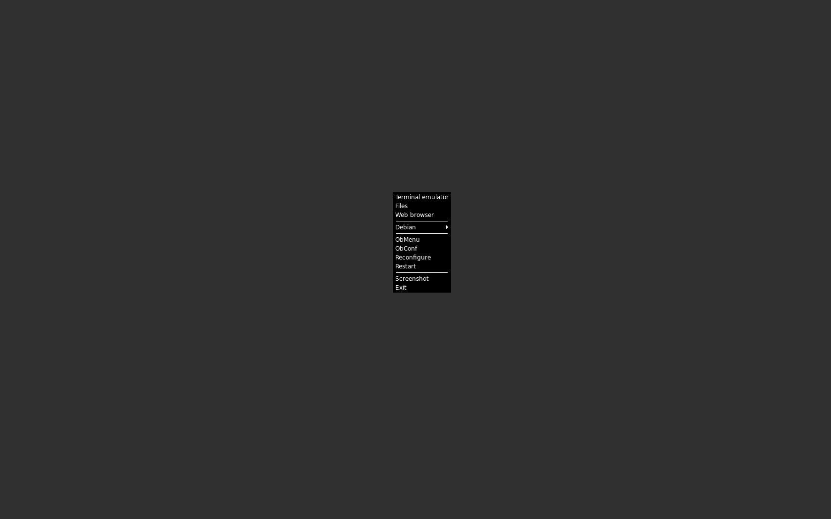

Oh and bear in mind you're not limited to one desktop environment with Linux, you can install several and choose which one at login if you wish.
For when you've had enough of clutter, you can't beat Openbox 🙂
