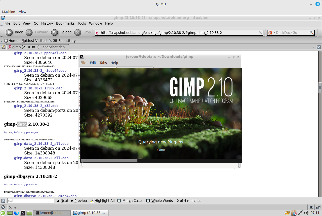

The only major "hole" I have left is a decent image editor. GIMP won't install and digiKam is not present. I need to do some digging and see what else is "out there" in the Linux world for image editing.
GIMP is being built...fingers crossed! It will take hours I think.
Too bad, it gave an error....
The problem as I see it now is that GIMP fails to build with the newer gcc14. In Bookworm, gcc12 was used and compilation of GIMP worked with that compiler. I am trying some fix I found in the GIMP developer's page related to the particular error I get. For the interested nerds:
Again, no luck. I give up.

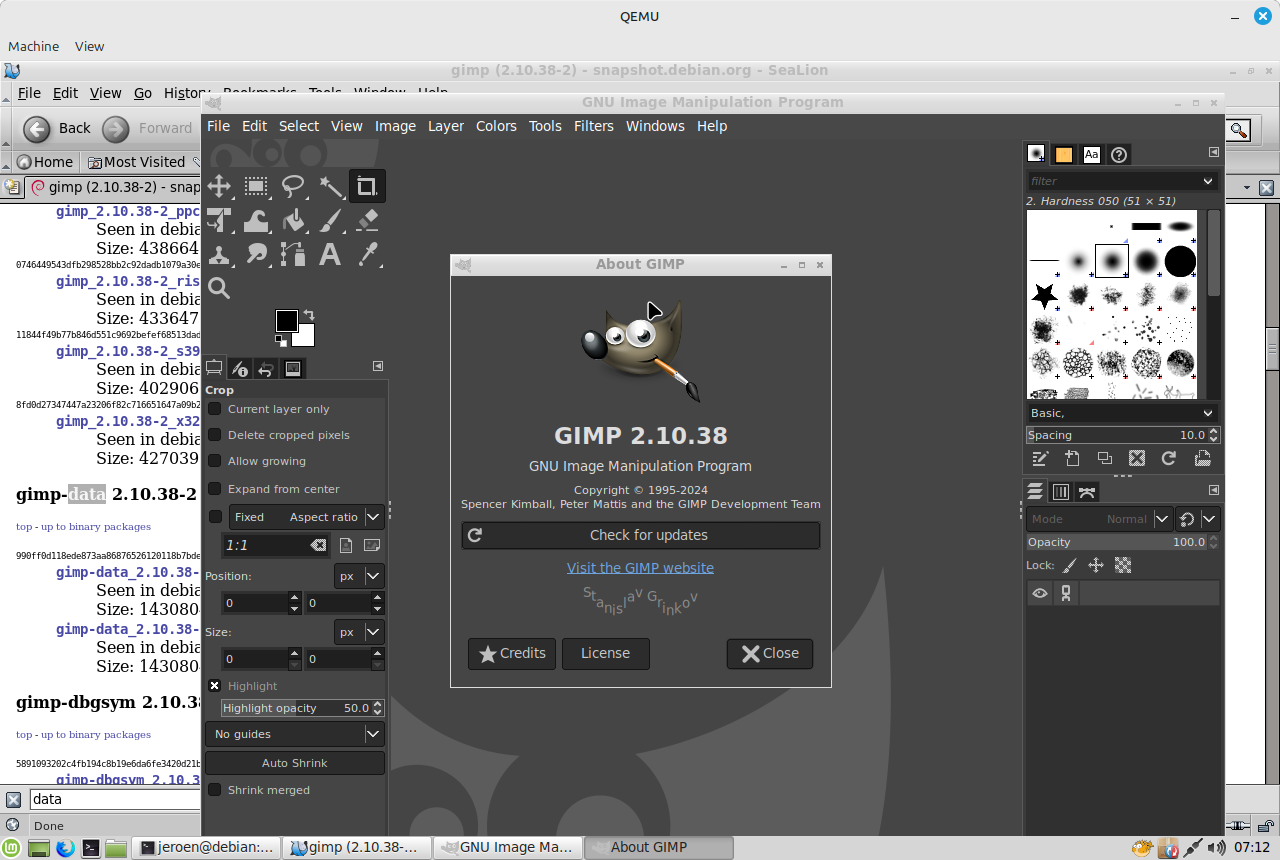

I added a hack in my repository to be able to install an older version of GIMP.
In your ppc64 system with MintPPC64 repo do the following:
Code:
sudo apt-get update
sudo apt-get install gimp-data=2.10.38-2
sudo apt install gimp
sudo apt-mark hold gimp-data
This should pull in all the dependencies which are available.
