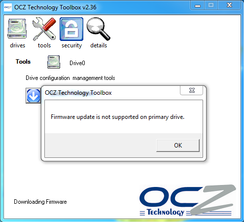

I have heard reports of this working but I have not been able to confirm it. When I try I get the message the updating is not supported on the primary drive.
