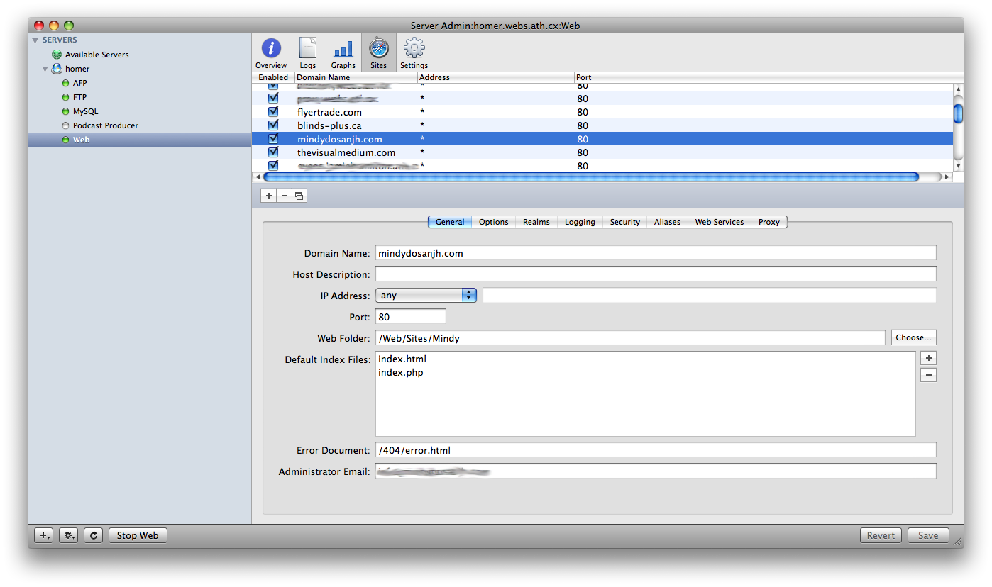

My hosting company used to use Ubuntu servers until we switched to Leopard Server. I love using Server Admin instead of endless .conf files 😀
I'll warn you that Xserves are a tad noisy though...
that looks nice. very mac, just the way i like it.
