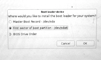

After I had done all this, I rebooted and saw the rEFIt menu. Then I installed Linux onto the paritition I created specifically for that (disk0s6). Note/edit: when you install your OS, make sure you don't overwrite your MBR. With Ubuntu there's an option to install the boot loader on your partition (rather than over the MBR), but in Windows I'm not really sure how that works. Proceed with caution... In Linux I installed the boot loader on /dev/sda6 (my partition) rather than on /dev/sda (the MBR) as shown below.
