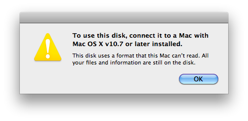

Hello,
I had to downgrade from Lion due to a couple incompatibility issues--important enough to force me to downgrade. I made a Time Machine backup of my 10.6.8 state prior to upgrading to Lion. My backups are on a external USB drive.
Here's what I'm working with:
- MacBook5,1
- Internal SSD 128 GB
- External USB Drive (original Macbook5,1 320 GB)
- USB 2.0 enclosure
- Weeks of Leopard 10.6.8 backups
- About 1-week worth of Lion 10.7 backups
1. I rebooted my MacBook and held down: Command+R
2. I restored from Leopard 10.6.8 Time Machine backup
3. Restoration went smoothly
4. USB drive is now showing "Incompatible Format"
5. I only have Time Machine backups on the USB drive from Leopard AND from Lion (no partitions, no OS installs, nothing but backups).
Something tells me that Lion did something quirky?
I wish I took a screenshot when I booted up my Leopard restore--Mac OS X told me that "...the USB Drive is incompatible but all my files are safe..." Something to that effect. Disk utility claims, "Incompatible Format."
Note: I formatted this drive in Leopard, NOT Lion.
Screenshot:
Any solutions? TIA

Have you and the OP opted to use Lion's FileVault on the partition in question? I believe that's what Apple_CoreStorage type is, and Lion's FileVault is different than SL. If you remove FileVault encryption, you should be back to a normal partition type.
Try this: Boot off Recovery HD and run DiskUtility. Select the Time Machine partition. Under File > Turn Off Encryption, turn off the File Vault encryption.
Run terminal, and "diskutil list" command again, I'll bet the partition type is now Apple_HFS.
Hope that fixes the problem. Sure threw me, as I don't use encryption.
don't know how, but it works now.
Thank you for your help. :)
