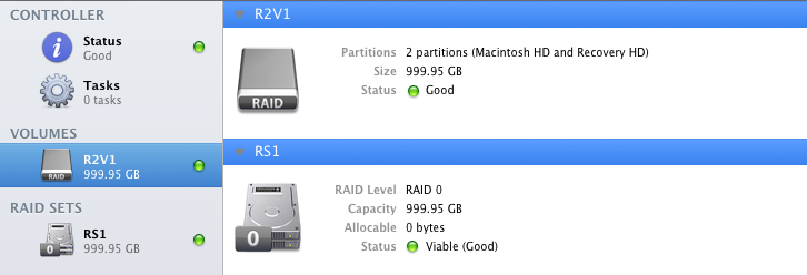

Hi guys,
I just installed the latest version of Lion on a RAID 0 volume. I downloaded it from the App Store, created a boot DVD and installed it without any issues, showed no warnings and also created the Recovery HD partition for me, on the RAID 0 setup (see attachment).
It was my understanding it couldn't create the Recovery HD partition but seems to be working fine...
