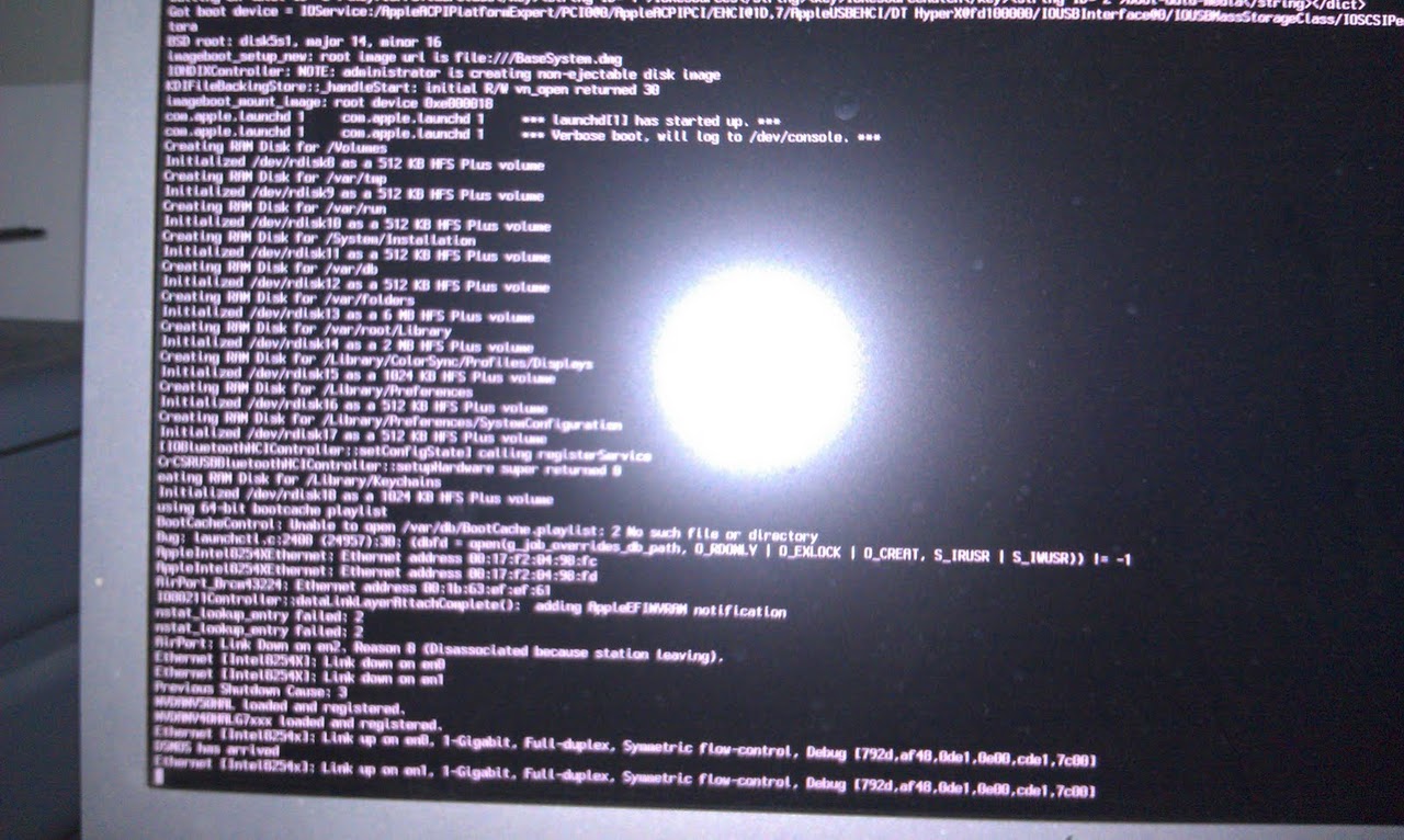

Edit: used verbose boot (cmd+v on boot), and from the screen I get as far as the Ethernet ports check out, then nothing, so still no idea what the hang up is.

Downloaded the Lion installer, selected my boot drive, rebooted...the system displays the grey screen and the spinning gear. Eventually the spinning gear freezes, and then nothing, no matter how long I wait. Power cycle required.
I tried using two different drives as the install destination. I tried installing from a DVD and a USB thumb drive. I have pulled all harddrives out except the install drive. I've pulled out all peripherals and controllers except the graphics card (GE8800). I've disconnected all external peripherals. I've even downloaded a different copy of Lion.
Each and every time I get the same result, freeze at the spinning gear.
Is there a log file kept somewhere that I might view that shows what the install is hanging on? I looked in the console and there is an installer log, but it stops at the point where Snow Leopard reboots and nothing shows past that.
I've repaired/verified the disks, and reset the PRAM.
Anyone have any ideas what else I might try if there's no log? I spent 7 hours on this yesterday, and I'm running out of things to throw at the wall in frustration. 😱

Finally resolved my issue and got Lion installed.
My graphics card (nVidia GeForce 8800GTS) was not supported by Lion out of the box. I contacted the seller who provided me an updated ROM for the card, installed it, then installed Lion without issues.
