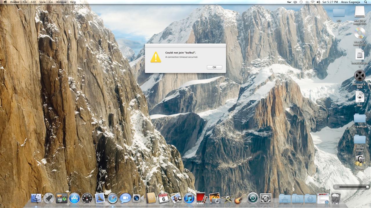

After intsalling Lion I can not connect to my Wi-Fi at all. When I try to connect it just says. "Could not join <name>, a connection timeout occured" I even did a clean install of Snow Leopard and then installed Lion. Its not a problem with my router because my iPhone, iPad, MBP, and other computers still connect to it fine. The MBP also has Lion and works great. I am using a 21.5in iMac from January 2011. I have attached my system info. Any help would be greatly appreciated. Right now I'm using an ethernet cable and its working fine.
Here's a link to my System Information: http://db.tt/dWki32z

Did you find a solution? I'm experiencing the exact same problem right now. I just updated to 10.7.2. I had no problems running 10.7.1.

Remove the network and add it manually
I just removed the network for the Preferred network list (Sys Pref->Network->Wifi->advanced ->wifi) , then added it manually (with the + sign under the list) with a wrong password and tried to connect, the password window showed up and when I entered the correct password, it worked perfectly, hope this helps

Delete your keychain entries for the WAP
The problem for many of you is likely a corrupt entry in your keychain. To fix this, open up "Keychain Access" (in "Applications/Utilities") and search for the entry which matchs the name of your wifi network. Then, select all the matching entries (there were two in my case) and delete them.

Simple Solution
A very simple trick that worked for me:
Just change the WLAN password of the router.
When lion try to connect just enter the new password.
Hope that helps.

I had the same problem with my Mac Pro/Airport Extreme combo and I figured it out. The problem is the laws of physics don't allow radio transmission between multiple transceivers all broadcasting/receiving at the same frequency without interference. Here's the fix..
Go to About this Mac > More Info > System Report > Network > Wi-Fi. Scroll down to Local Wi-Fi Networks. You will see a list of all the networks in your neighbourhood/hall of residence/prison cell complex etc.. 10 or more if you're unlucky. You will also see your one. Look at the Channel numbers. Chances are, yours will be the same as the guy next door, or at least someone nearby (mine was shared by two others!). Now just pick a number no-one is using (from 1 to 13) and remember it.
Now go to your router and change the channel to your chosen number. The procedure will vary according to the make. If you have an Airport extreme you just go to Airport Utility, click on your router and go to 'Wireless options'. It will take a few seconds to update, then you'll be back in business. I've had a full strength signal ever since.
