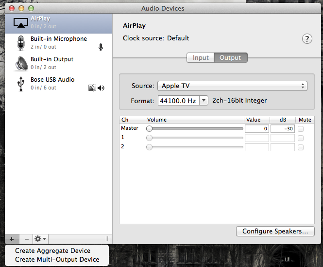

If they are both hooked up via USB, you should be able to create an aggregate device using the audio midi setup.

The software solution that a couple of people mentioned is either beyond me or doesn't work. In any case, I could not get it to work. In addition, whatever device I get, I need to be able to control the volume on the computer speakers easily since the volume adjustment on the speakers is inconvenient.
