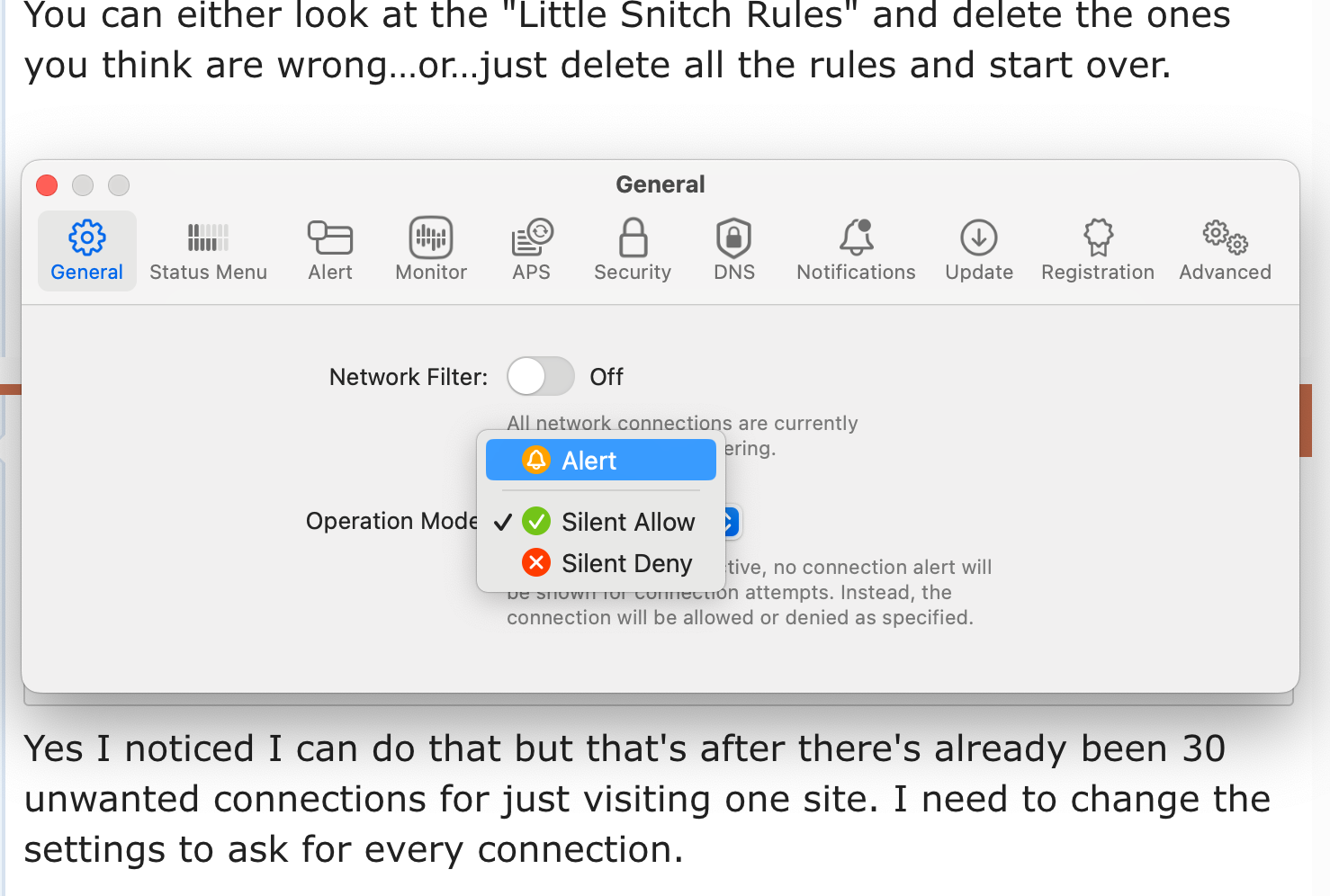

I am a new Little Snitch user and would greatly appreciate some assistance with the settings. I'm on Sonoma 14.7.
What settings do I need to receive alerts for every connection? I think I messed something up and a bunch of connections I don't want are getting through with no alerts.

Yes I noticed I can do that but that's after there's already been 30 unwanted connections for just visiting one site. I need to change the settings to ask for every connection.
LS > Settings > General > Operation Mode:
Select "Alert"
