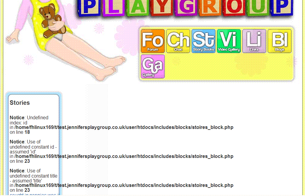

hiya im working on my test development http://test.jennifersplaygroup.co.uk now if you go to my stories page then click on any story and then on a comment it comes up a error
Code:
Warning: mysql_fetch_array(): supplied argument is not a valid MySQL result resource in /home/fhlinux169/t/test.jennifersplaygroup.co.uk/user/htdocs/includes/story_comments.php on line 23
I been looking though the code but can't seem to be able to find the error

the error is still there, and it is set up with order correctly. the message says
Code:
<?php
while ($row = mysql_fetch_array($sql, MYSQL_BOTH)) {
print nl2br($row[3]);
print "<br />By $row[2]<br /><hr><br />";
is were the problem is

ok im giving a few things a try it seems to be printing out invalid id, this may be because of the way the page is set up with ajax that the two php documents are not seeing each other properly so im going to try to solve it as best i can. secureing the code is on my list of things to do but only once it all works.
ok so the current formula

I just visited the site, http://test.jennifersplaygroup.co.uk/ and saw a series of Notice: errors under the Stories menu on the left of the page. Are these the errors you are currently trying to fix (see attached)?
We will need to see the code on your file /includes/blocks/stoires_block.php (note the misspelled filename, this is how the file is actually spelled - maybe this is causing some other issues?).
The error you had in a previous post was corrected by adding quotation marks around your array keys. I would imaging that since the Notice warnings are the same, that the same issue is occurring.
So look for something on line 18 of the file stoires_block.php that looks like:
Code:
$row[id]
and change it to
Code:
$row["id"]
And the same would go for "id" on line 23, and "title" on line 23 as well.
Are there other errors you are still getting?
