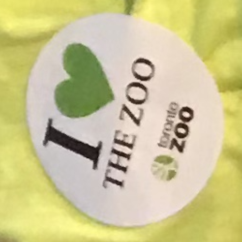

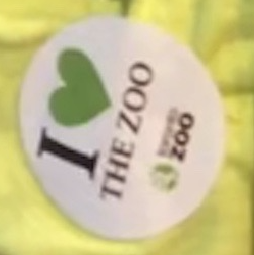

I just tried this on my iPhone 7 Plus, with iOS 11 Public Beta 4.
Original Live Photo exported as JPEG is 3024x4032 and 2.2 MB.
Edited Live Photo with new key frame exported as JPEG is 2744 x 3662 and just 1 MB.
And yes, the image quality of the latter frame is noticeably worse. Here are some screengrabs of blown up detail of text on sticker.
However, the original key frame for this particular Live Photo is unusable, so despite the decrease in quality, I still value this feature. The original key frame has my son in a half-blink so he looks stoned out of his gourd. The later frame has his eyes wide open, so even though it's softer, it is usable.

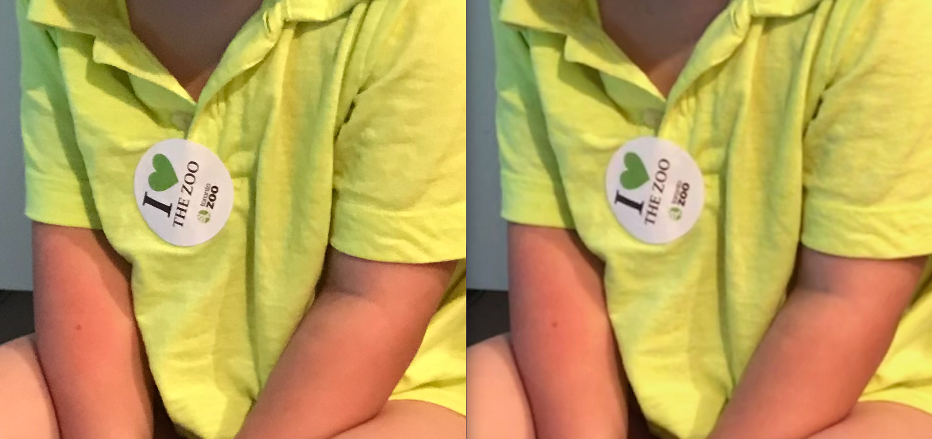

[doublepost=1502247083][/doublepost]Here is a crop of the two photos side by side. Original key frame on left, new key frame on right. (Click to enlarge.)
There seems to be a large amount of noise reduction / blur applied to the second image.
