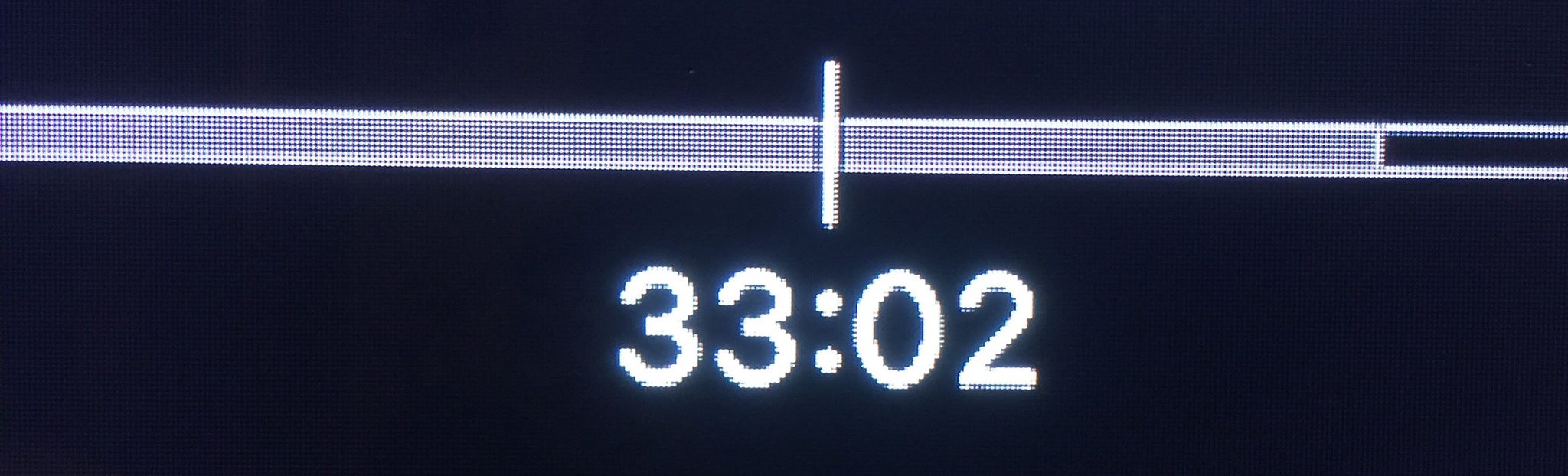

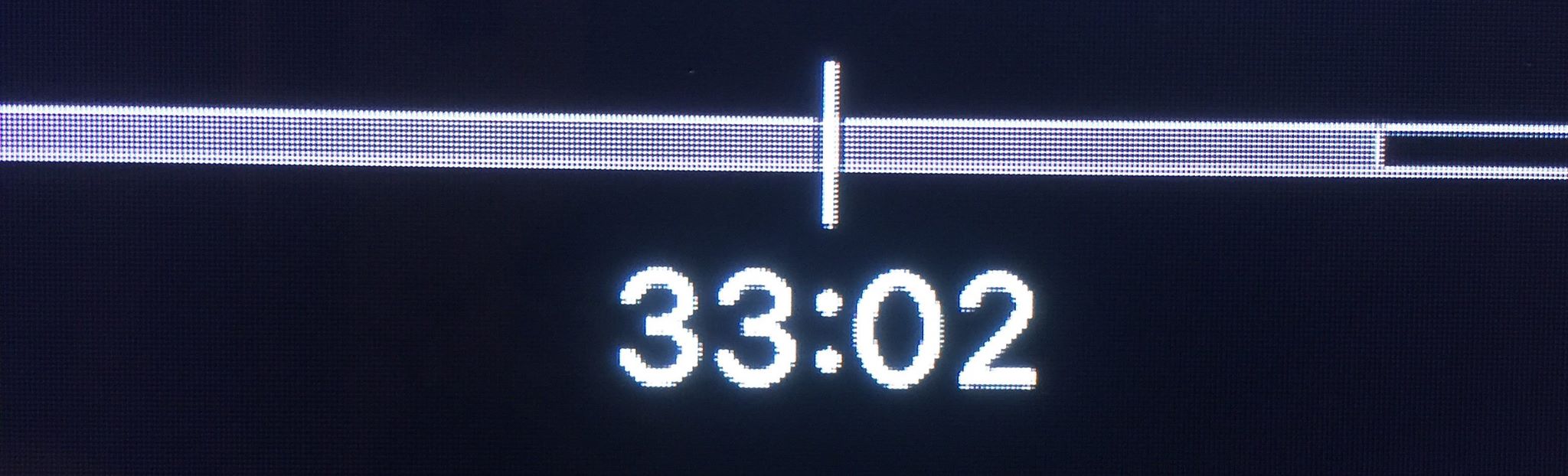

My Apple TV seems to be choking on Local HD content purchased from the iTunes store, when you play a HD film/movie from Computers from a local iTunes "Home Share" it keeps buffering it doesn't cache ahead like the Atv 3 so you keep getting buffering it happens on wired and wifi.
When I play the same film on a Atv3 it is fine and on the progress bar you can see it caching ahead a good 20 or 30 min's
When I play a SD film on the Atv4 it caches ahead fine
If I play the film via the store after it caches enough the film plays fine, im beginning to get the feeling Apple would prefer we didn't manage our own content libraries....
No im hard wired at the mo from the computer to the router which is 1Gbit and the Atv4 has been hard wired and wifi with the same outcome...

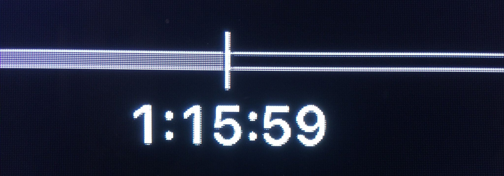

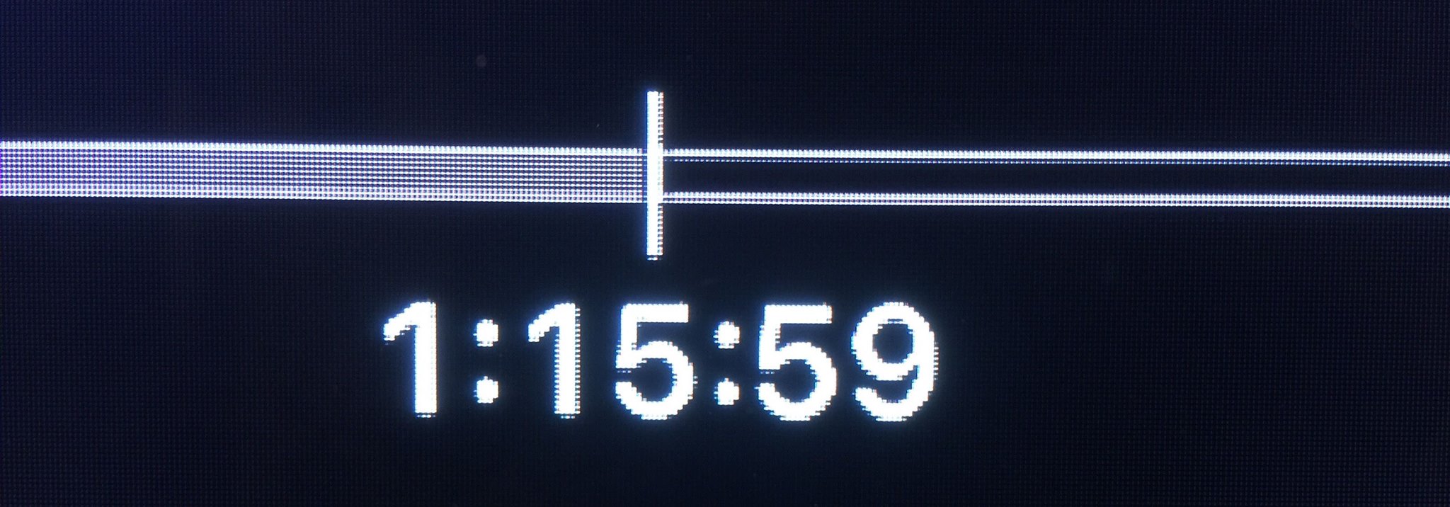

On the HD versions of films there is no cache ahead of the position bar
Here is the SD progress bar

Here is the HD Progress bar

Mine is pre-buffering just fine in HD. If it works with SD but not HD for you, it looks like there is a bandwidth bottleneck somewhere (on the ATV, your network/router, or the computer).
The HD film has no read ahead cache and if I pause the film network activity ceases, but when watching a SD film it has plenty of read ahead cache and when you pause the film on the atv it continues to pull the film across for read ahead cache

@6AL5 The smaller the files are, the more video caching ahead i have. Totally different to the ATV3. I have those problems with both, purchased and own ripped movies. The app airvideo has a network connection test included, i have perfect results there. I think its a ATV4 bug.
