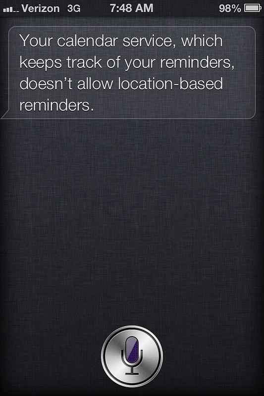

I've had my 4S since launch and with iOS5 was never able to get location based reminders to work - at all. I could set reminders but they would never function. Upgraded to iOS6 last night and was hoping that now I could get them to work. Well, now when I ask Siri to set a location based reminder I get this error message:
"Your calendar service, which keeps track of your reminders, doesn't allow location-based reminders."
Any thoughts? I've tried changing my default calendars in case that was the problem. Won't work for my gmail calendar, work (outlook) calendar, or iCloud calendar, or "From my Mac" calendar. And yes, I have location services turned on. Anyone have any idea what's wrong here? I'd really like to use this feature as I think it would be very helpful. Thank you.
You have to disable reminder sync on your Exchange account. Then location based reminders will work. If you enable them on your Exchange account, they won't work, even on other accounts. Weird.

Took me a second to find that because my "Exchange Account" is Gmail and that option isn't available. My "Work" account (which I renamed) thru Outlook/Exchange however did have that setting. Turned it off and now it'll at least accept my reminder request. Now lets see if it actually works.
However now I'm guessing that since I disabled reminder sync for my work calendar I will no longer get reminders on my phone which were setup at work on my work calendar? I'll test that out. But if it doesn't work then I'm not sure which one I need more. This would literally be two steps forward, two steps back. 😡

It's in Settings - Mail - <your exchange account> - Reminders. Turn that off.
And no, unfortunately that way reminders created on that account through other means won't be synced to the iPhone, and you won't be reminded. Guess you can't have both. It's a bit stupid if you ask me.

I believe that I figured out how to get both to work. Just switch your default reminder list in settings to Reminders. I'm not sure if it may also be necessary, but Calendars may need to also be enabled in iCloud settings.
