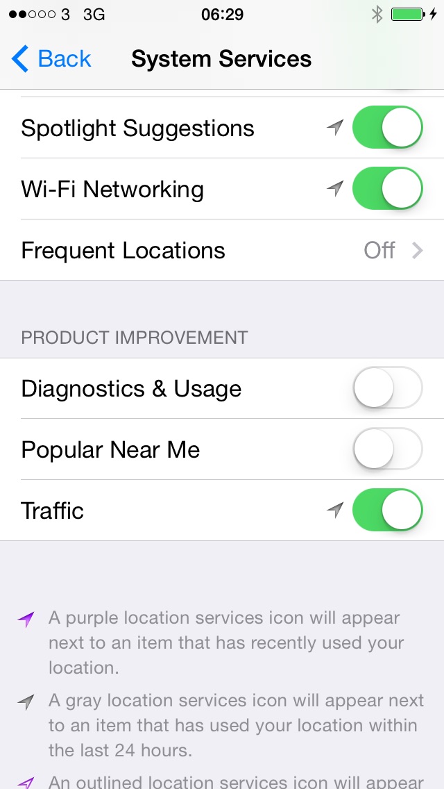

I solved this problem by going to Settings > Privacy > Location Services > System Services and toggling "Popular Near Me" on and then back off.
Hope that helps!
Hope that helps!
Didnt work for me 🙁 I can see its the app store causing it. If you set App Store to Never use location in Privacy a pop up box appears asking to change settings and then it re-activates itself and the arrow icon never goes away from the home screen.
Hmm, that's odd. When I set the App Store to Never on Location Services, it would stay set to Never, but still show the purple arrow next to App Store and in my status bar.
Then I followed the process I posted earlier and that solved the problem.
Not sure what else you could try, but I hope you're able to solve it!
