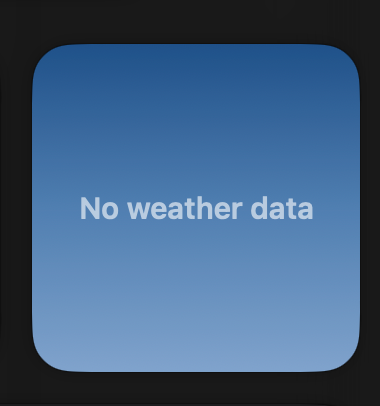

I have an M1 Max Mac Studio on 13.2.1 and seemingly since the install of 13.2.1, Location Services on this Mac is unstable. I originally made a thread here ( https://forums.macrumors.com/threads/location-services-borked-after-13-2-1-update.2380818/ ) but I'm not 100% sure it's purely a 13.2.1 thing so I'm wondering if others are seeing similar behavior on Ventura. I never did see this particular behavior on Monterey on this system or my M2 system that still has Monterey.
This Mac Studio is my everyday system. It is my primary system for my work-from-home job and it sees very little down or offline time. It'll go weeks or months between shutdowns or reboots (it does sleep though when not in use, of course). I do use a VPN client for work when needed and only when needed, and it's used to tunnel very specific network connections and not everything, e.g. no systems services whatsoever are tunneled. So I don't think the VPN is part of the Location Services woes here.
Essentially what happens is Locations Services ceases to function. I usually spot it first in the Weather widget because there won't be any data there. I'll then confirm it further in the Maps app (which can't find my location either) and in the Find My app. To "fix" the issue I merely log out and log back in -- no reboot is necessary.

hey, the location services on my MacBook Air hasn't been very reliable after updating to the latest Ventura release as well. just like you described, one of symptoms is that the weather widget shows forecast failed and the weather app as well as maps are unable to detect the location. rebooting the system and manually turning the location services off and on will make it start working again. but one of the more efficient ways I figured out is you can just force restart the location services process through the activity monitor, this will do the same magic. the process name is locationd. if that's still too much of a hassle to you, try use this bash code to force restart the locationd process, I suggest you create a shortcut and put it on your menu bar so you can run it whenever the services dies.
On my MacBook Air M1, which has the same problem from time to time, putting it to sleep and waking it up again often fixes it too. Quicker than log out/back in again.

And I have to amend my above post that the launchctl trick in fact does not suffice to fix this. The CoreLocationAgent will be stopped and then started again on demand the next time a location-aware app is used, but the situation remains the same: no location data.
Bouncing locationd works fine though.

I also noticed today that the Console app reported these fault and error messages when the location services crashed:
fault 16:20:45.880423+0900 locationd {"msg":"Not registering for location updates; desiredAccuracy is too high", "client":[root]\/System\/Library\/Frameworks\/CoreWLAN.framework"}
error 16:20:46.272595+0900 kernel Sandbox: locationd(346) deny(1) mach-lookup com.apple.PowerManagement.control
error 16:20:46.273499+0900 locationd IOPMAssertionCreateWithProperties: pm connection failed
fault 16:22:02.964370+0900 locationd {"msg":"Not registering for location updates; desiredAccuracy is too high", "client":"[root]\/System\/Library\/Frameworks\/CoreWLAN.framework"}

Just hit this again this morning on 13.3 Mac Studio. The workaround continues to be the likes of

This just cropped up again today. It's been a long minute since I've seen this one happen -- the usual telltale signs of the Weather app not having data for my location and Maps not knowing where I am.
