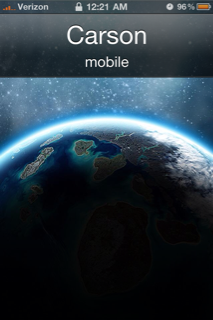

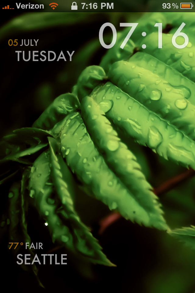

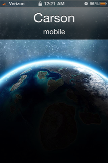

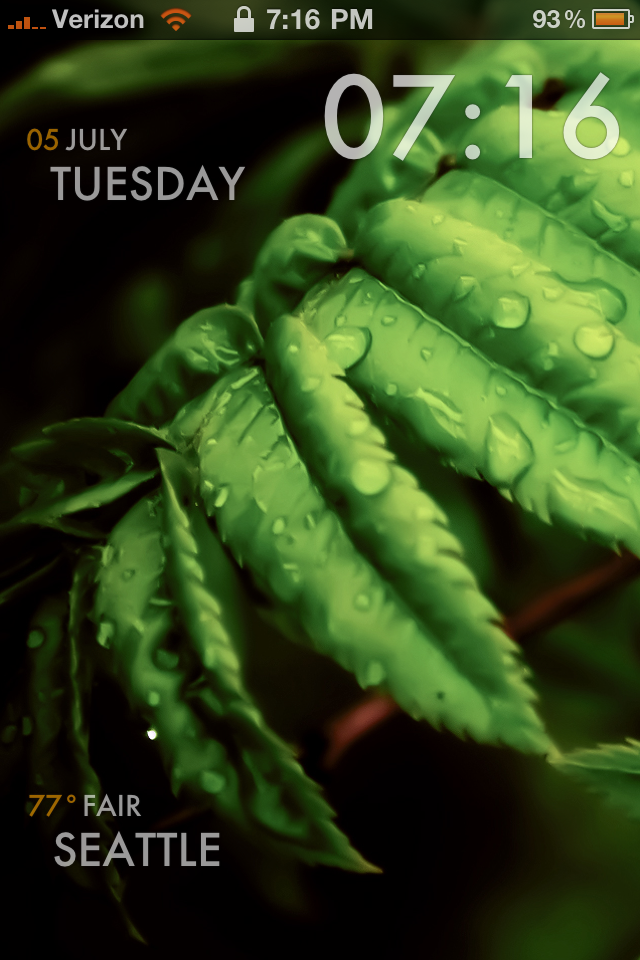

Hey all, I am having a problem with my lock screen. It's a cool theme that I found, but as you can see in the 2nd picture, it makes it so that there are no buttons when a call comes in and my phone is locked. The buttons appear fine when I am using my phone or the lock screen is turned on, but if the phone is locked and the screen is off and someone calls me, I get no buttons.
Can anyone help me out? I have no idea how to fix this. Did some research and couldn't find much... thanks so much for any help.

What exactly was your problem? As you can see from the first screen shot, my lock screen takes away the slide bar/buttons at the bottom of the screen, so I think it has to do with that.

The weird thing is that I can answer calls just fine by tapping the bottom of the screen (which is how I unlock it from the lock screen). But I want the buttons back.

Sounds like you have images replacing the buttons as a part of your lockscreen theme. Navigate to /Library/Themes/<your theme>/Bundles/com.apple.TelephonyUI/. Delete bottombarknobgreen.png and bottombarknobred.png and the @2x versions.

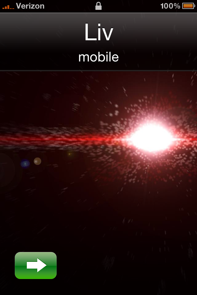

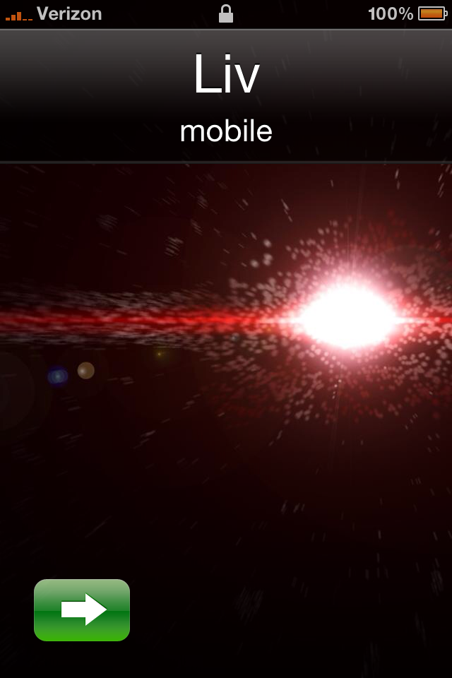

Wow, thanks! That worked! Here is a new image of my incoming call screen. Looks awesome, although the slide to answer bar isn't fully there, I'm just nitpicking now 😛
