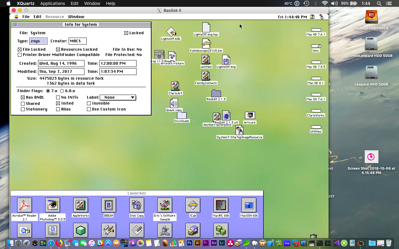

I tried the ResEdit technique to lock down the 7.5.5 System file, but it booted up and behaved normally (in BasiliskII). I was then able to uncheck "Locked" in the System file's Get Info window while it was running.
I'm wondering at this point if you can't just do a drag and drop copy of the hard drive onto your external device to copy the entire system, then use Drive Setup (or was it HD SC Setup?) to re-initialize the drive and copy the backed up files back into place.
