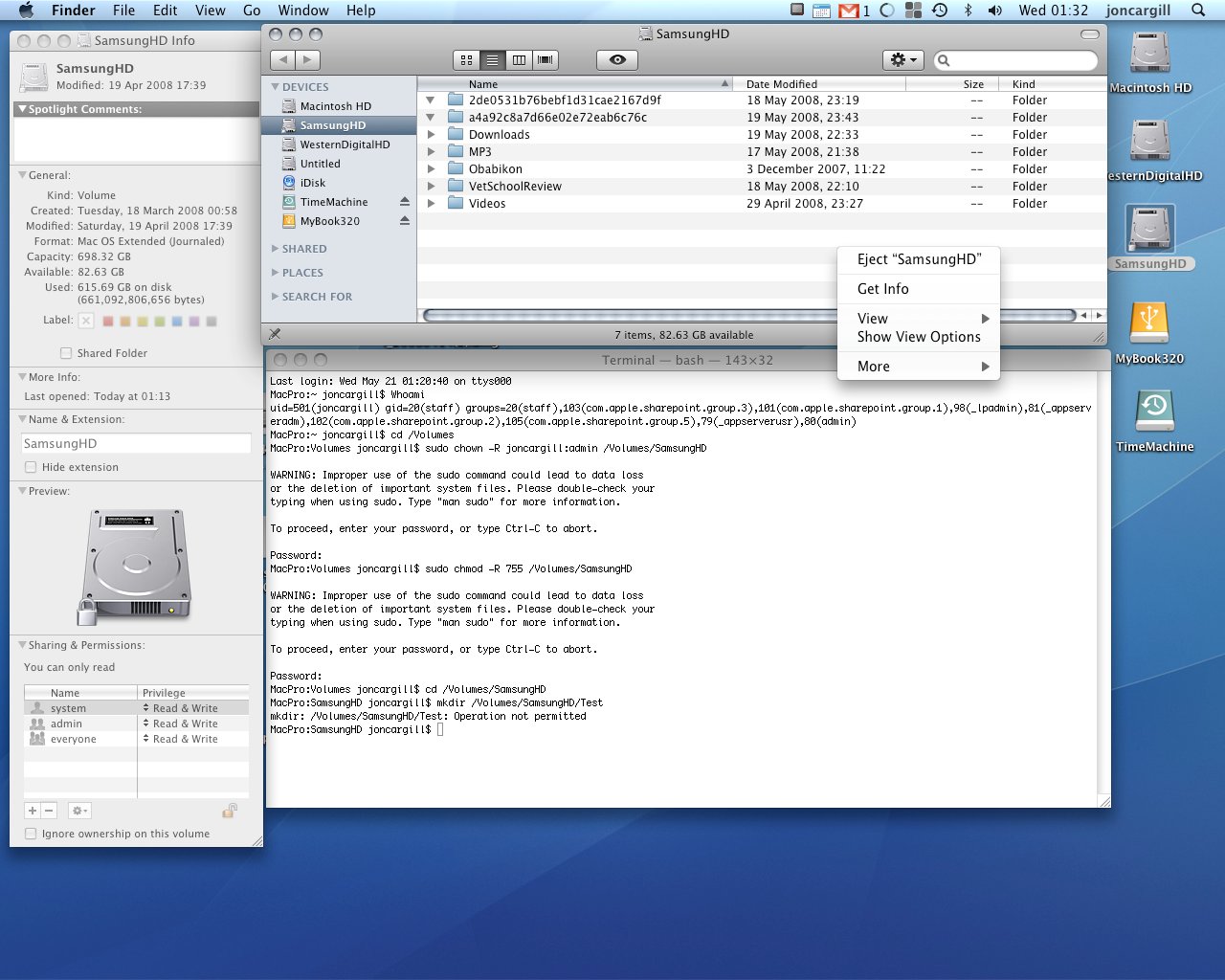

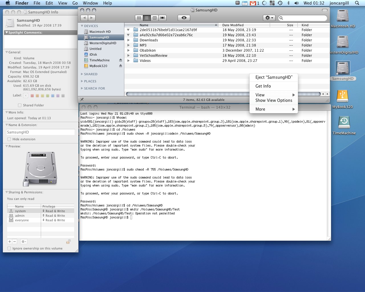

In the finder, select the disk and go a "Get Info" on it. If you see at the bottom of the window "Ignore ownership..." is checked, uncheck it. Also, if you can get a screen shot of the window, post it here. I helped someone else with a similar problem and it was only when I saw the screen shot that led me to the solution.
Locked Internal Drive
I think I've got the attachment on this message...
This is one screenshot with all the stuff.
You can see the drive icon with the lock on the Samsung icon on the desktop
You can see the Ignore Ownership is unchecked.
You can also see the privileges on the volume - very intersting
You can see where the option to create new folder is not allowed in the GUI or the Terminal command.
You can also see the chown and chmod commands run again.
Thanks for your help!

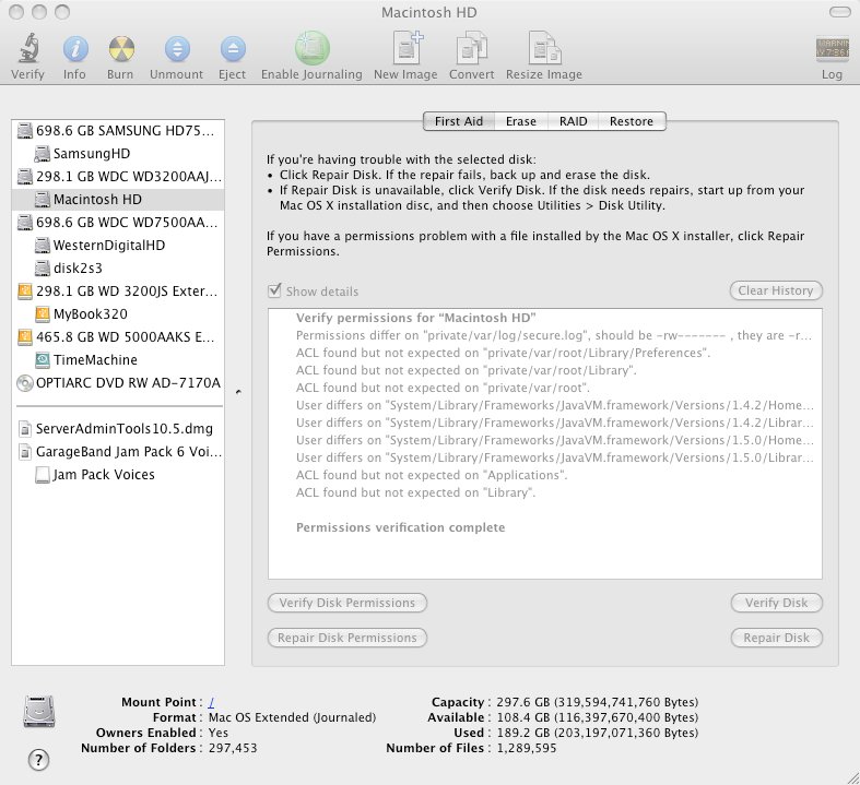

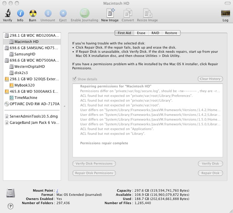

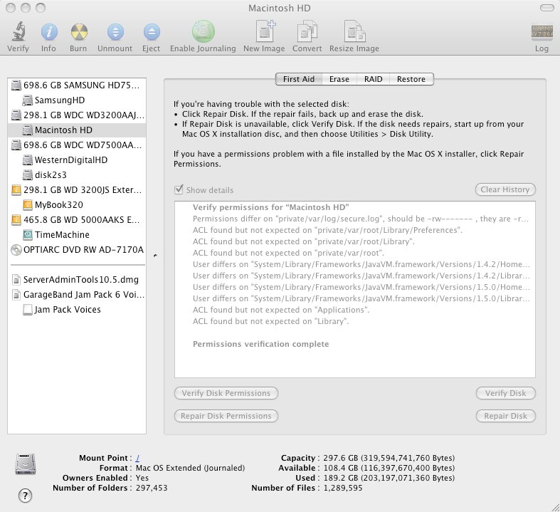

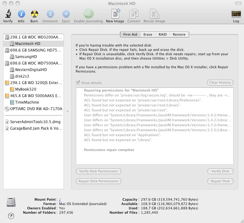

First, run Disk Utility First Aid and repair permissions on your boot disk.
See if that fixes the problem. If not proceed...

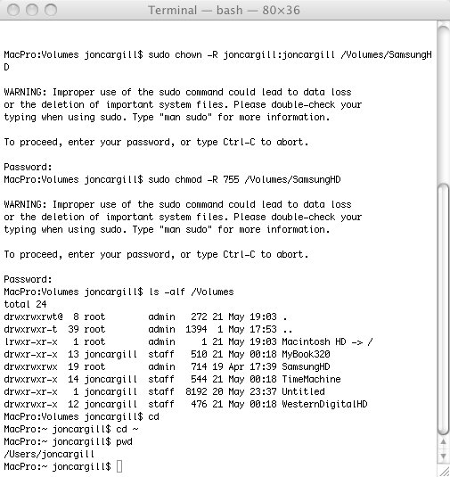

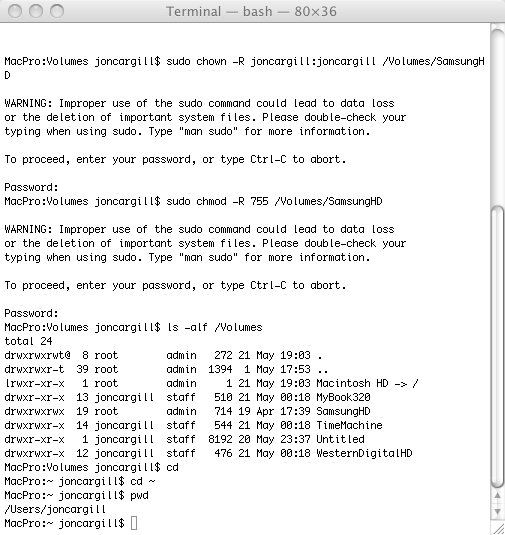

In Terminal run this:
sudo chown -R username:username /Volumes/yourdrivename
sudo chmod -R 755 /Volumes/yourdrivename
where username is your shortname (like your home folder). Note this is a bit different than before where your username is also your group name.
Then type the following in Terminal and post the output:
ls -alf /Volumes
Also what is your "home directory name (shortname) on your boot disk?

I have completed these steps, with screen captures attached.
Unfortunately, still no solution.
Home folder name = joncargill
Although frustrating throughout the process, I'm learning loads of stuff. I've only had a mac for a couple months now, so this is some good practice at some basic work - screen grabs, terminal commands, etc. Thanks
Ok, I looked at your terminal output. It looks like the system wants you to be the root user in order to run the command, so type the following (commands are in bold) in Terminal:
sudo -s
This makes you the root user
ls -al /Volumes
chown -R joncargill:staff /Volumes/SamsungHD
chmod -R 775 /Volumes/SamsungHD
To exit from root user, type exit
Post the output from the terminal window so we can have a look see.

total 8
drwxrwxrwt@ 7 root admin 238 May 22 19:36 .
drwxrwxr-t 39 root admin 1394 May 1 17:53 ..
lrwxr-xr-x 1 root admin 1 May 21 19:03 Macintosh HD -> /
drwxr-xr-x 13 _unknown _unknown 510 May 21 00:18 MyBook320
drwxrwxrwx 19 root admin 714 Apr 19 17:39 SamsungHD
drwxrwxr-x 14 _unknown _unknown 544 May 21 00:18 TimeMachine
drwxrwxr-x 12 joncargill staff 476 May 21 00:18 WesternDigitalHD
MacPro:~ root# chown -R joncargill:staff /Volumes/SamsungHD
chown: /Volumes/SamsungHD: Operation not permitted
MacPro:~ root# chmod -R 775 /Volumes/SamsungHD
chmod: /Volumes/SamsungHD: Operation not permitted
MacPro:~ root# sudo -s
sh-3.2# ls -al /Volumes
total 8
sh-3.2# chown -R joncargill:staff /Volumes/SamsungHD
sh-3.2# chmod -R 775 /Volumes/SamsungHD
sh-3.2# exit
exit
MacPro:~ root#
Yes, you have a mess of stuff that doesn't look correct, not only on the SamsungHD, but MyBook320 and TimeMachine as well. I hope you have backups.
I suggest you first repair permissions on your boot disk and then re-format/erase the other three drives. Don't do it as root, but do it as your user account.
