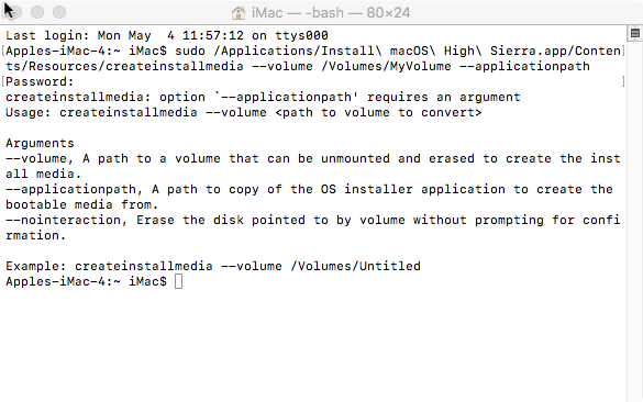

Well, although I managed to sort out the p/word issue, I still can't install from the USB. Could somebody Kindly interpret the 'arguments' on the attached image. I've obviously done something wrong, but I can't see what. Thanks again in advance.
High Sierra does not need the applicationpath command at all.
In your terminal, delete everything after/Volumes/MyVolume
Is that (MyVolume) the actual name of your destination volume? That name needs to be what the volume name is, for the destination volume. Your command to create the volume will rename it, but you do need to make sure that the volume NOW is the same as what you have in your command, otherwise you will quickly get a "volume does not exist" or something similar. Much simpler (and no typing errors) is to just drag the volume into the terminal window, which will properly format the path to that volume.
