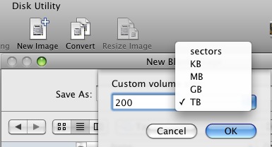

1. The first time you open the disk image, the dialog will have a checkbox whether to store the password in your keychain. If you don't check this then it won't be stored and you'll have to manually enter the password every time you mount the image.
2. You have the option when you create the Disk Image to make it read and write, which gives you the ability to add and delete files from the image at will.
One more point, when you create an image, it's best to choose the sparseimage format. When you do this you will want to specify it's size at the largest size you expect the contents to grow to. The sparseimage will not initially occupy that much space on your disk, but will grow as you add content into the image until it reaches the maximum size you specified when you created it.
