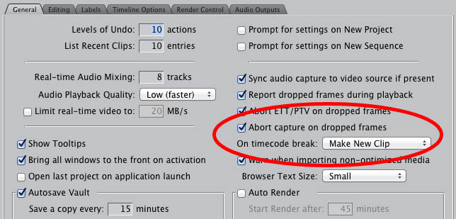

I'm pretty sure it's a preference setting to detect camera start/stops and to make them into separate clips. It's like how with newer solid-state cameras, you get one video clip for each time you start and stop the camera. Makes it easier to sort and organize. Glad I don't have huge blocks of DV footage anymore 🙂
That was my initial thought but the OP said when he borrowed his friend's camera it worked fine. Worth double checking that setting though.
The setting you need to check is this one.
