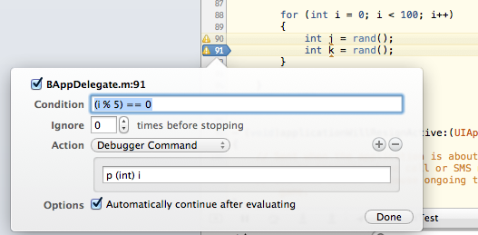

Here you go. This doesn't break at all. It just logs the value every 5th iteration.

OP, you miss the point. Whatever the condition is that you want to have a log use that. Also, you can add a counter that increments each time through the loop.
The concepts are "conditional breakpoint" and "breakpoint action." You set a condition and it breaks. The action can print or run an applescript or several other possibilities.
