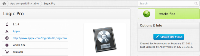

i'm wondering if anyone has had any experience with running Logic 9 on Mac OSX Lion.
According to http://roaringapps.com/apps:table Logic 9.1.4 still has issues when using Lion.
I'm not switching over till i know for sure if Logic 9.1.4 is fully compatible with Lion

Logic 9.1.4 and Lion
I'm not having any issues here running Lion, Logic 9.1.4, Waves, izotope, EZ Drummer and Native Instrument Plugs.
The first time I ran Logic after the upgrade It did take about 5 minutes to rescan all the AU plugs I use.
