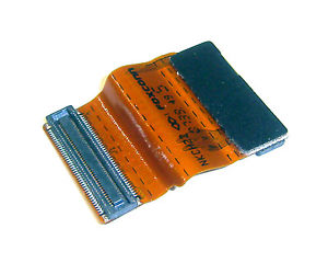

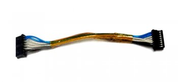

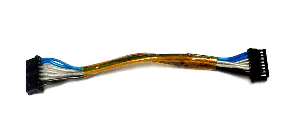

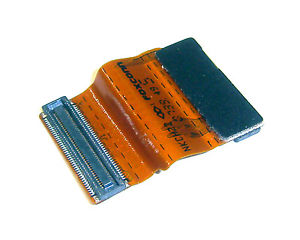

Hi
I have attached photos of the cables
The thin one and the fat one
Two cables on the I/O board, as the OP sees it correctly. The connection for I/O is the round cable. I THINK the ribbon that connects underneath the I/O board is mostly for the express card reader, which attaches to the I/O board.
Oh yeah, I forgot the express card slot was surgically attached to the I/O board!
Either way, whether it's ExpressCard or HDD, it won't affect your test.
