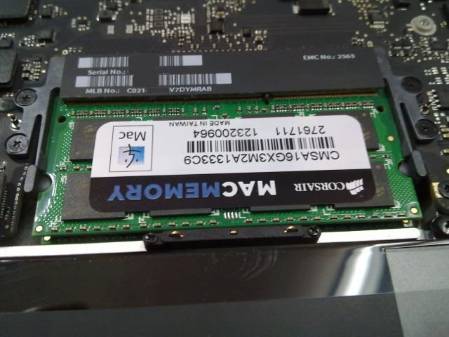

If you want to find out the specific model number for the logic board you will need to go under the hood and take a peak (it was like that for my old macbook pro). Here is what I saw at apple discussions,
"Your logic board will have it's own SN, separate from your computers's SN. Called the EEE or logic board number. The EEE number is the last 3 of the last 4 numbers/letters of the logic board SN, IE: e801513wefpua, the EEE number is fpu. That's what you want to look for. It will be on a barcode...."

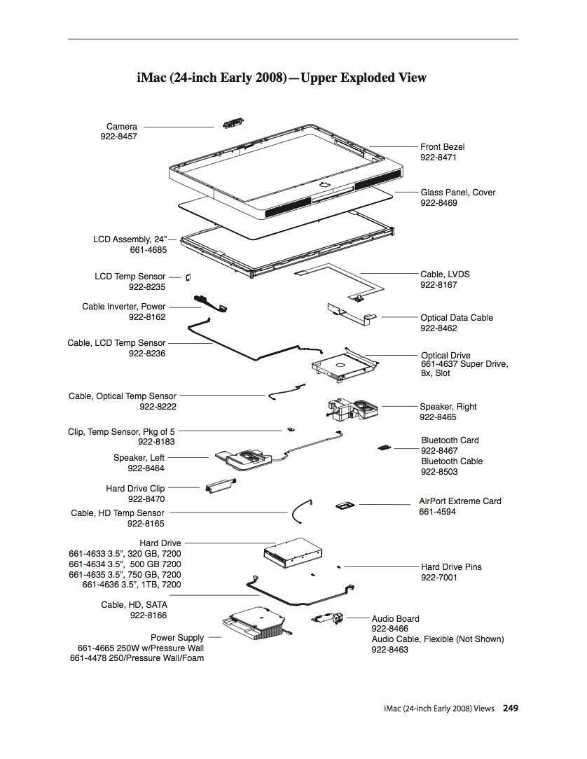

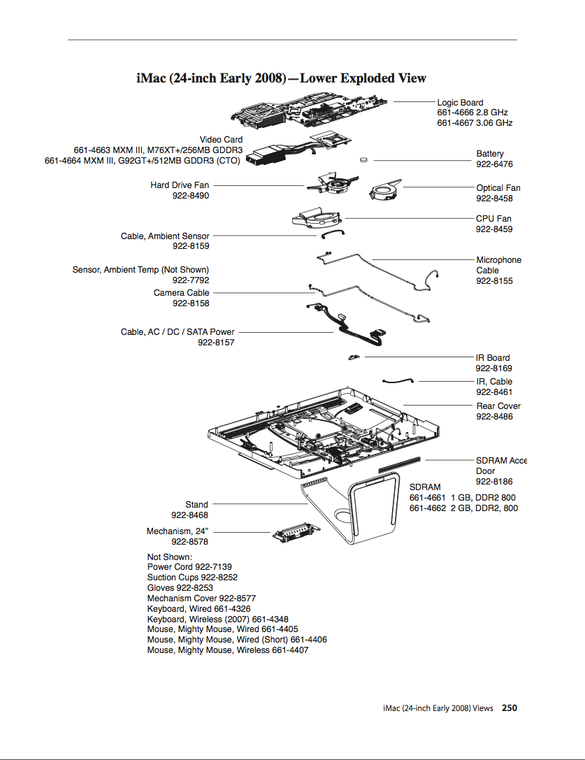

These images supposedly came from the Service Manual for the Early 2008 iMac (24"). According to them, you need:
661-4666 for the 2.8 GHz logic board and 661-4667 for the 3.06 GHz one.
