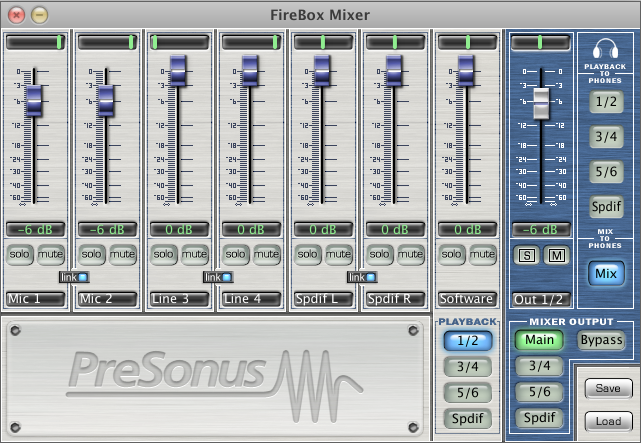

Levels for the FireBox ins and outs, and the routing of signals are handled by the FireBox Mixer app.
If you aren't seeing (and using) something that looks like the above pic, you're not going to get very far with recording anything. You actually need the FireBox Mixer application and Control Panel. Both apps come on the CD that should have shipped with your FireBox, but you can download both from this page at PreSonus, under "downloads". The FireBox instruction manual, which you might want to read for info on how the mixer app works, can be downloaded under "manuals" from the same page.
